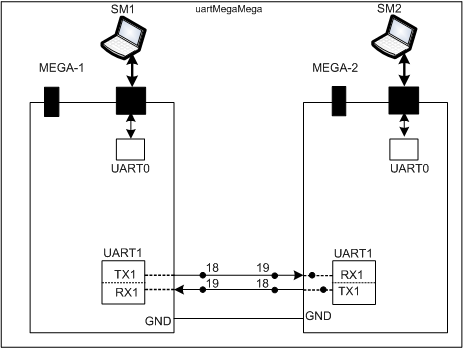

1. Which Arduino are you using - MEGA, ESP32?
2. If using two MEGA, then make connection as per Fig-1.
3. To send an uint8_t type data (say; unint8_t y = 0x23;) at 1-sec interval from MEGA1 to MEGA2 over Serial1 Port, You may upload sketches similar to the following into Sender (MEGA) and Receiver (MEGA2).
Figure-1:
