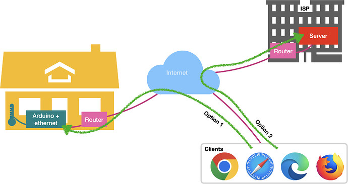

You have two options
Option 1: you make your Arduino visible from the internet and it becomes the one serving the web page displaying the temperature sensors. This requires poking holes into your home network and there is no need for the intermediary, internet hosted, web server.
Option 2: you want to go through the intermediary, internet hosted, web server because you don't want to/can't open your home network.
In case of option 1, you develop some code on the arduino so that it builds a web page when accessed from a web client. This code can read the sensors and send the exact timely information out.
in the case of option 2, you'll need two services on the hosted server. One service that will "record" the sensors' values and one service that will generate and send the web page out to the clients. The arduino code reaches out from time to time to the first service and say "here are the current values" and when a client connects to the server, the second service reads back the latest values from "somewhere" and builds a nice web page and sends that out. It often takes the form of two PHP or python scripts running on the server but not always.
If you don't want to archive a log of all the sensors' values in a database, the first script (the one receiving the sensors' values from the Arduino) could generate an HTML document on the server (so a static page) and the clients would always access this page. There would be nothing dynamic in the page, it will just be a "document" that gets updated every time the arduino connects.
Another option is to just save the values in a small file on the server (like a mini database holding only one record in an easy to read format, like JSON) and the second program would read that file and generate the web page dynamically.
makes sense?

As I said, if you don't need historical data, there is no need to store this info in a "real" database.

Sorry but that does not make any sense.
The server does not display anything. The client browser does and it displays whatever it got from the server.
So if you want to connect from your PC to your server, say using Firefox and that without touching anything on the PC, the values of the sensors change dynamically, then the web page needs to be built in the right way and there needs to be a path from the data in the arduino to that Firefox managed window on the PC. The way the page refreshes itself needs also to be coded, there are a few options for that.
You need to decide first if you want to go from the Firefox browser straight into the Arduino (option 1) or if you want to get the web page from the hosted web server.
That will influence how the rest of the code and architecture is designed.
