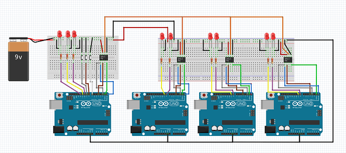

Hi I am making a project to conect 1 master arduino UNO to 3 slave arduino UNOs using MCP2003 chips to send data using LIN comunication, I have sucsesfully set the comunication up to send a simple signal and response between the master and slaves with LEDs to signal the when the data is recieved at both the slave and the master, every time i press the relivent button the correct LEDs flash.
However i want to send data that is gathered from sensors on each of the slave arduinos alongside the signal data, when i try to do this the signal and response only work the first time I press the button and does not work on subsiquent presses.
I want to read data from a nine axis motion sensor shield which i have got working seperatly from the main project it is the data from this i want to send to the master along with the identification code.
See below for wiering diagram and code for master and 1st slave and 9 axis motion sensor

Slave code

Thankyou for any help you could provide
It does not sound like you have an upload problem or a problem with Avrdude, stk500, or Bootloader; hence your topic has been moved.
With a single master system such as LIN you need the master to ask the slaves if they have data and if so what it is. By definition a slave cannot originate a message. In a multi master system such as CAN each node becomes a master and it can put its data on the bus whenever it has it or at a predefined schedule. All nodes will receive the data and chose to use or ignore it.
Try this link on LIN: Local Interconnect Network - Wikipedia or this one: LIN Bus Explained - A Simple Intro [2023] – CSS Electronics
For CAN: CAN bus - Wikipedia or communication - Is the CAN bus protocol a master and slave protocol? - Electrical Engineering Stack Exchange
In my system I used CAN, it is a lot less software as the controller does the heavy lifting, much faster and built in error checking.
Thanks for the quick reply
I have the master set up to ask the slave for the data this is what this piece of code is for
if ((millis()-lastDebounceTime2) > debounceDelay){
    if (reading2 != button2State){
      button2State = reading2;
      if (button2State == LOW){
        byte msg[] = {
          0x47, 0x48, 0x49
        for (int i = 0; i < sizeof msg; i++){
          Serial.write(msg[i]);
And this works and causes the first slave to respond with a basic identifier response however if I try to sent the variable information from the sensor alongside the identifier this is when the system only works the first time and then doesn’t work for subsequent requests for information from the master to the slave
