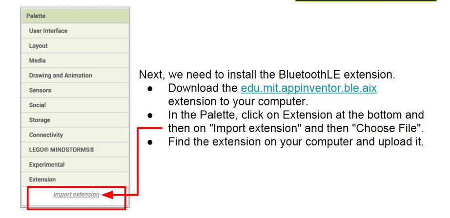

and this is a small app I created to check if I recive the data:
for some reason I see the sensor reading in the monitor but not in the app.

Well, that´s another issue. My wife´s phone also uses IOS. I´m doing this project for her and I don´t make any idea of how to develop an app to Apple devices. This is why I considered the possibility to use a laptop. My phone uses Android and MIT Inventor can handle BLE if you download the appropriate add-on.
Take a look at http://iot.appinventor.mit.edu/assets/tutorials/MIT_App_Inventor_Basic_Connection.pdf
This is where I got this :point_down:t2:
Thanks again for the tips!
Thanks for the info, I will have a look.
