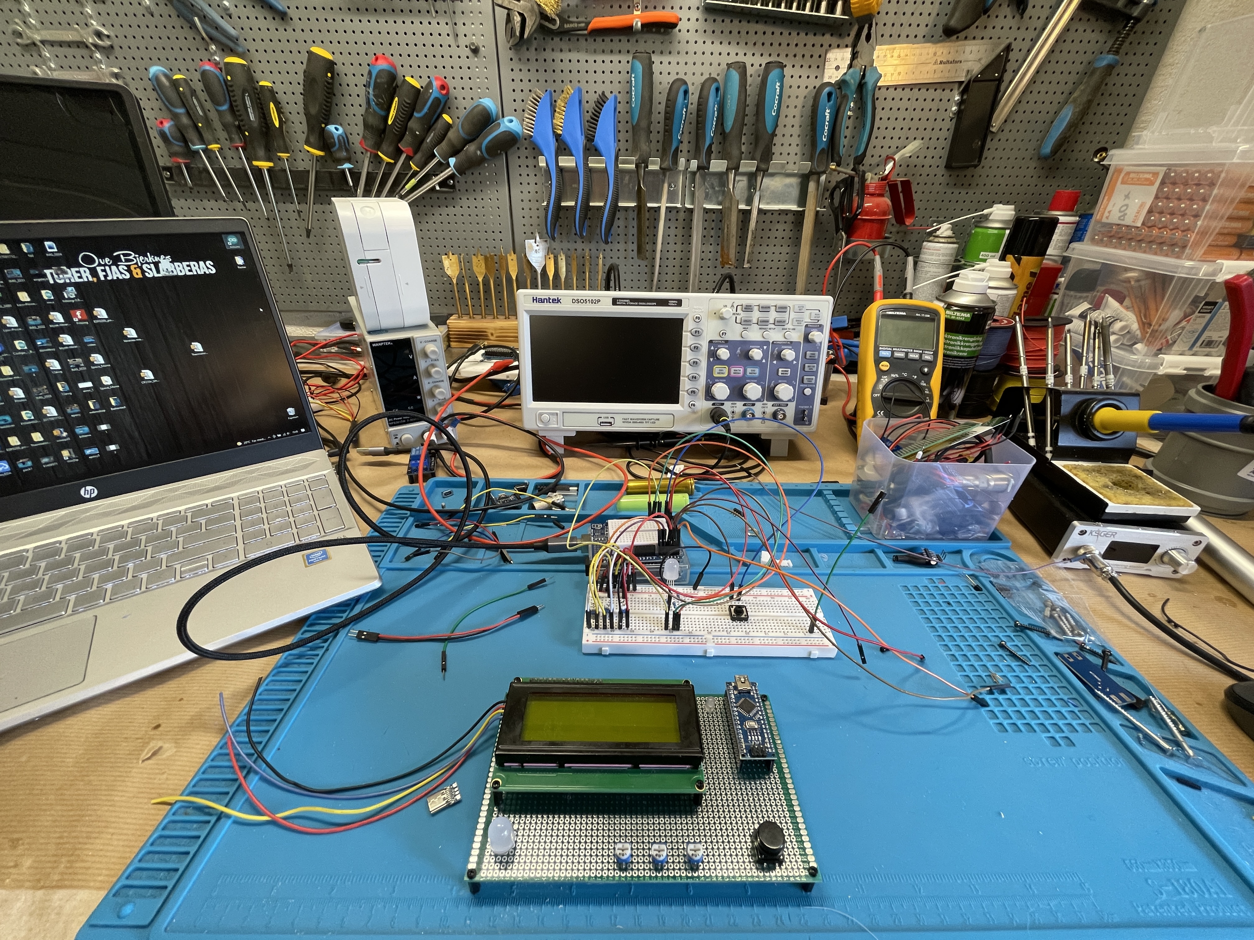

Some progress update. From breadboard to perfboard.
The project is no finished and works perfectly. :slight_smile:
Here is a short video and some pictures, and off course the code.

Didn't like my suggestions, huh?
Yes, but when i get the circuit to the perfboard i must changed it back to «255».
I don't understand your response.
That was one of your suggestions.
I changed to that and that fixed the problem when i have my circuit on the breadboard.
But when i soldered my circuit to the perfboard i had to change it back to «255» because the led turned off when i give the potentiometer full value.
Nope, still not understanding your reply.
"R / 4" is simple and correct - it gives an even distribution of values.
"map ( R, 0, 1023, 0, 255)" is expensive and incorrect - it gives an uneven distribution of values.
"map (R, 0, 1024, 0, 256)" is expensive, but gives the same results as "R / 4"
