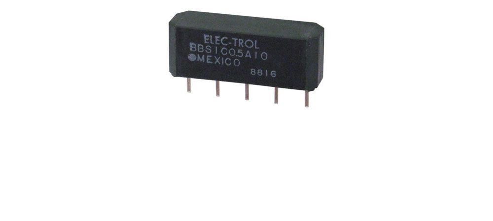

The switches could be reed relays as Richard Crowley pointed out in another thread (info below).
I'm still holding out hope for the analog switches, I think they would be better suited for vehicle use, nothing mechanical to bounce around. I have a question in to Maxim asking about isolation if the switches are hooked up like this.
5 VDC SPDT REED RELAY US$1 each ($0.85 each for 10 or more)
Elec-Trol # BBS1C05A10. 5Vdc, 205 Ohm coil. S.P.D.T. switching action.
0.99" x 0.30" x 0.35" high. Single-in-line pc pins. 5 pin on 0.2" centers.

Maxim got back to me. You are right about the isolation. Having the common from the 0V battery connected to the common from the 100V battery is too much voltage difference from input to output. Looks like relays would be the way to go.

VBB can be up to 80V. So, 8V across a 205 ohm coil.
Not sure how to find a relay, am having a hard time finding specs.
Exactly! This chip will let him write out to a big shift register with plenty of drive capability to control relays across the batteries - turn on one relay at at a time, isolated from all others, and measure the DC on that battery using the ADC in the arduino.
Stack 4 chips up, control 80 relays, stack up 5 for 100.
