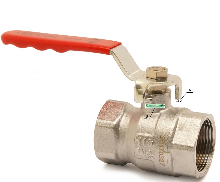

Sensor to detect open or closed ball valve?
Need some feedback/info for how to detect if a ball valve like the one below, is open or closed?

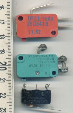

Microswitches:

The pipes are copper - non-magnetic, but the valve is magnetic (but I'm not 100% sure since it is located at my cabin far far away). I can check this the next time I'm at my cabin.
One problem to consider is that the valve shall be used by humans and the sensor must be of a type and mounted so that it's function is not "damaged" by handling the valve.

Microswitches:
I can try to use one (got several). But I suspect that a microswitch will make it difficult to use the valve.

Before I posted my question I was thinking of using either some sort of optical sensor or a hall sensor.
What do you want to know? Is a reassurance that the water was turned off by the last person there? I ask because I am wondering whether a water meter detecting flow would be sufficient.
Hello, I'm inclined to do it magnetically:
If we glue hard, (epoxy glue or similar), and in the correct position, (distances, angles etc), an A magnet and a
rele reed, the problem is solved.
I'll consider the magnet reed relay solution. Got reed relays but no small strong magnets.
Not if it is properly designed, like these commercially available ball valves with limit switches.

Strong magnets are definitely NOT needed for reed switches. I don't see how a reed relay could possibly help with your project. Just be sure the N-S magnetic field is aligned with the metal reeds in the switch.

For a prototype solution I would just tape a bar magnet to the underside of the handle and cover the whole assembly with a piece of heat shrink tubing, or perhaps wrap with self fusing butyl tape. From an ergonomic point of view the increase in diameter might actually make it easier to use.
Put the reed switch on top of the copper pipe. Check to see if the valve body magnetizes enough to cause false readings.
I would go with an optical or magnetic method with the most robust component on the handle.
It could be a reflective dot or a strong magnet. You can get them with a screw hole to fix them.
