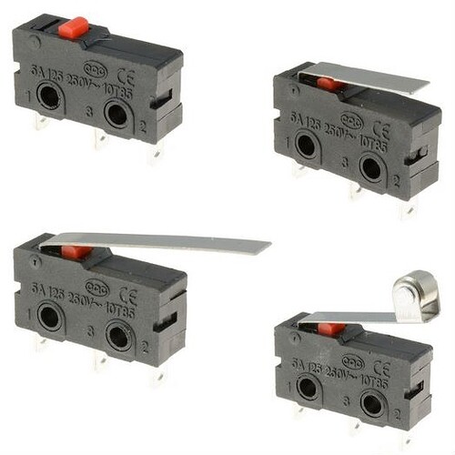

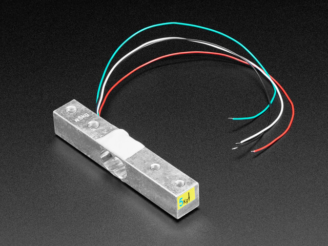

I have a board with a piece of plexiglass that sits about an half inch above. When an object lands on the plexiglass i need to register an event (just recognize it happened)
Challenge: the sensor has to be undermount the plexi glass.
Consider a microswitch

  • A load cell.

A bean bag about 3in^2
It could be dark outside and it doesnt have to be a sub second response.
About 6oz
A microswitch would work well in that case.

If the obect is 3in^2 6oz and my surface area is 48inx24in it would seem logical that i would need many controllers based on the plyability of the plexiglass. These devices seem to trigger based on pressure against the switch. Yes?

Correct. Obviously, to find a method that works reliably, you will need to do some experiments.
