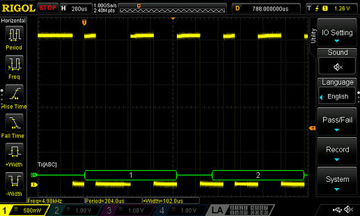

The result is that the serial signal still only has one stop bit.
Solution
I found out that UARTE1 corresponds to Serial. So, I was modifying the wrong UART object. After changing the base register address to that of UARTE0, which corresponds to Arduino's Serial1, everything works now (the signal now has two stop bits), as you can see in the two attached pictures.

Signal viewed with an oscilloscope
For testing, I just wrote two arbitrary characters ("1" and "2" which correspond to 00110001 and 00110010) over the serial monitor, which then were transmitted via Serial1 to be checked with an oscilloscope.
Before the config changes, one can see that after the first byte is transmitted, the signal line goes HIGH for one bit (STOP bit) before going LOW again (START bit) of the second data transfer.
After the config changes, the signal line stays HIGH for double the time (two STOP bits) between the two pieces of data being transmitted.
