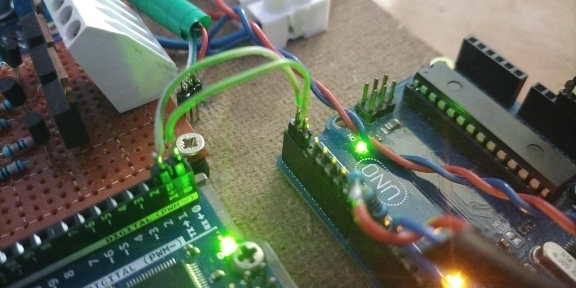

Hello! The project I'm making is a "smart workshop" system. Right now I have Arduino Uno R4 as a main brain and Arduino UNO R3 acting as a graphics card with TvOut library onboard.
The Arduino UNO R4 uses hardware Serial1 interface, and R3 uses Hardware Serial with lightweight pollSerial library. Both at 115200 baudrate. Through this Serial port, the R4 can send text and simple commands to add a new line, clear the screen and add simple graphics. The problem is that every transmission, on random positions there are appearing random characters (that aren't even recognized by TvOut library).

whole board (pretty much only the arduino boards are used here, the rest is waiting for later development
Serial Connection:
Arduino Uno R4 is powered using USB-c only (I'm afraid that cheap 12V-5v converter will break and fry this expensive board)
Artifact inside "testing" text
When "graphics card" doesn't recognize the command, it displays the message "unknown cmd:", as you can see here, the artifact appeared in the middle of the new line command
Total mess, because the &clear command got corrupted and screen was not erased
This time it attacked the rectangle command
No comment
This is what boggles my mind this weekend, if you have any ideas or more questions (maybe something needs clarification), let me know!
My theory is that might be a timing issue between Arduino R4 and R3 as these have very different clock frequencies. Maybe the problem is with the pollSerial Library?
I also tried changing drastically the baudrate to 4800, but the artifacts changed to 'w' characters, Weird...

Is there a reason why the whole thing could not be run on the R4 ?
Yes, the TvOut library is pretty outdated and hard-coded for only a few Atmel AVR microcontrollers. Also it looks like the only library that fit my needs, and I don't feel like engineering a Arduino Uno R4 NTSC library from scratch (although it could be interesting). Another benefit is that the Uno R4 is not slowed down by heavy computing required to accurately send analog signals to the TV.
Understood
Have you considered other communication protocols between the boards such as I2C ?
Whilst I know nothing about it I am suspicious of the pollSerial library. What happens if you just use the normal hardware Serial library ?
I used the pollserial library because of this one feature that doesn't work with regular serial
TV.set_hbi_hook(pserial.begin(BAUDRATE));
hbi stands for horizontal blanking interval, and (from what I understand) by hooking the pollserial to it, Serial port operations don't block video generation (and vice versa). I know nothing about pollserial library too, this line was borrowed from TvOut library example here.
And here is full TvOut Library mirror (as the original was archived on google code)
Did you test the Uno R3 with the TVout by using the serial monitor instead of the R4? Simple sketch, read input from serial monitor and write to TV?

Yes and it's really weird, the sketch even in advanced form (with all the commands) works perfectly fine through serial monitor (even with long strings that take all the screen space), but for some reason the communication has errors only between two Arduinos.
Let’s start by eliminating the common errors (you’re new here, no offence intended but we have zero idea of your capabilities).
  • Is there a common ground between R3 and R4? If not, start there.
  • Otherwise, if you have a schematic, even ridiculously simple, that would help us. I think I know how you have it connected, but…
The use of the word “poll” implies to me that there is no interrupt involved in serial reception, rather the code needs to constantly check for character info. If that’s the case, reception at 115200 would be extremely flawed. I’d give that up, and try debugging the 4800 baud version.
edit - ugh, just saw your common ground comment. oops.

After a quick peek at the pictures, I see the "artifact" seems to be always the same (the same shape). It looks like something (?) is sending that byte thorugh the serial (the display tries to "interpret" it but probably it's a byte code outside the character map, pointing to an unwanted area), but I don't know either what is doing that or why. If it were a noise-generated artifact, it would be random.
I think so too.
