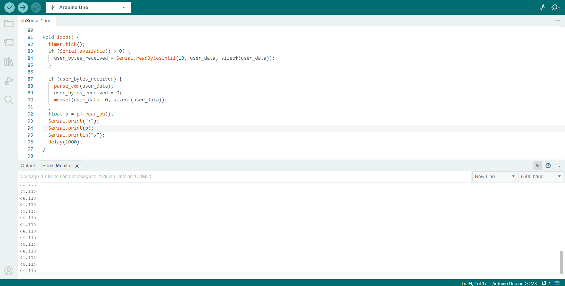

in my previous attempts i dont think serial.print worked but i can retry it tomorrow and let you know, i'll edit this once i find out
checking the pins now it could work that could legitimately work, I will try that out tomorrow and let you know
i could check this out but would def be the most intensive one just because i have to resolder connections, but if all else fails I will keep this one in mind
will try this and let you know
You did something wrong.
For help on this forum, post the code, explain what it should do, and what it did instead. People will be happy to help if you provide some information.
Theres no error, all thats happening is that the data is being printed in the serial monitor rather than sending over to the mega. The serial monitor open for the mega displays nothing; the serial monitor for the uno displays good data.
This was the case previously too, so i thought my only other option then was to rely on serial.write

Yep this is what iwas missing. I figured out that i would need to change the serial.read to serial1, but overlooked changing the serial.available
Everything is working fine now, for future reference; I essentially copied example 4 from Serial Input Basics and changed the serial commands accordingly. for the uno, print statements did work once i had the mega code working. Thank you, everyone for your help and patience!!
