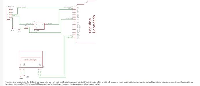

The problems like that :
the first uno send "?"to the second uno ,the second one has grbl
when i wiring first tx to the second rx,(gnd are com)
display correctly:

but when i also wiring first rx to second tx, it mess up:

wiring diagram:
https://drive.google.com/file/d/0B5MJn_ytEg7lUUVtLWdDd2QyLU0/view?usp=sharing

From looking at your first image it seems that you have the ArduinoA with GRBL connected to your PC and your ArduinoB is connected to the GRBL ArduinoA. What on earth are you trying to do?
And your diagram does not show any of the Arduino pin numbers. If your ArduinoB is connected to the same Serial port on ArduinoA as the PC is using it is not surprising if things go wrong.
And if GRBL is getting commands from the PC I suspect it is going to be confused if it also gets commands from another source.
This is one the best examples I have seen of the XY Problem. You really need to explain what you want to achieve and not start with some detail question about how you think it might be done

I would like to display Wpos and Mpos on lcd while grbl connect with pc.
I have found shapeoko forum and study their's code,but i can't understand how to isolate pc with grbl while display on lcd.

I did actually download your image so I could read it properly - just because I was a little bit interested in the subject.
I can't say I understand it either. I assume GRBL is on some sort of Arduino - but it does not say what type.
I don't know why the commentary mentions the GRBL Arduino's USB connection because the Leonardo in the diagram is certainly not connecting to it.
It is certainly possible to connect two TXs to a single RX. Two problems need to be solved.
First is the technical problem that the idle state of a Tx line (from the Leonardo, and from the GRBL Arduino's USB-TTL converter) is HIGH and if there are a second signal pulling the line HIGH when the first one wants to pull it LOW it won't work. The 4066 is intended to solve that problem - but I wonder if it does it properly, because it cannot affect the signal line coming from the GRBL Arduino's USB-TTL converter.
The second problem seems to me to be more intractable. How can the Leonardo ensure that it never tries to communicate with the GRBL Arduino while the PC is trying to do so.
Assuming BOTH problems can be solved I guess there is no reason why the Leonardo should not send requests for data to the GRBL Arduino. However I have no idea whether that might interfere with GRBL's ability to smoothly move the stepper motors.
By the way there is no suggestion in all of this that the GRBL Arduino would be doing anything unusual at the level of its serial communication.
Also, I don't see anything to suggest that a Leonardo must be used but the Leonardo and Micro have the advantage of having a spare HardwareSerial port on pins 0 and 1 which would simplify the programming. A Mega has 3 spare HardwareSerial ports.

When Leonardo communicate with grbl ,should isolate the rx line with pc. But i can't understand how to do that.
Leonardo should always send "?" so that grbl will response Wpos and Mpos.And it has no influence on stepper motion.

I don't know either - because AFAIK the data from the PC to the Rx pin on the GRBL Arduino goes through the Arduino circuit board.
However, even if you could isolate that signal you have to ask yourself if it would be wise to do so. What would happen if the PC needed to send some data?
