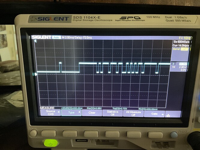

I am trying to take serial input from a device and read it on the arduino, however, despite the signal very clearly reaching the pin, it does not recognize anything. The serial format is 2400-N-8-1 and I am using an arduino mega.

Also attached is a picture of an oscilloscope reading coming directly from the Serial2 Rx pin(17).

If I'm reading that correctly, the signal coming into the Rx pin is well below 3V.
When Vcc is 5V, the minimum Vih for the 2560 is 3V.

On the scope what scale is the vertical axis set for V/Div?
It’s not a 2V minimum?
2V, as shown in the picture.

No, with Vcc at 5V, it's a 3V minimum for Vih, as shown in the datasheet.
The do have the data grounds connected, don't you?
