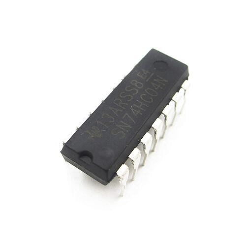

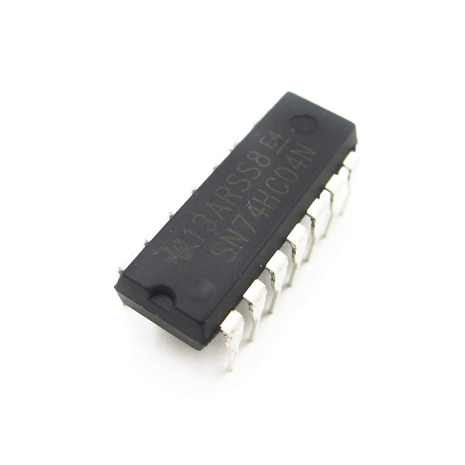

will this work? if so, what is the schematic for it? I was able to figure out how to power it, but not too sure how it will connect to the RX pins.
The chip contains 6 inverter gates (hence the same "hex") but you will need to use only one of these, it does not matter which one you choose. Connect it's input to the output of your voltage divider and it's output to the Rx pin on the Arduino. Don't forget to connect a 0.1uF ceramic bypass cap close the the power pins of the chip.

also, my local dealer has 74HC147 and 74HC595 in stock, will those work?

No. You need any 74hc00- series chip containing simple, inverting, logic gates. The 74hc04 you found on Amazon, for example.
Another example is 74hc00, which is quad nand gates. A "nand" gate is an and gate with an inverted output. Connect one of its inputs to Vcc and you can use it as an inverter.
