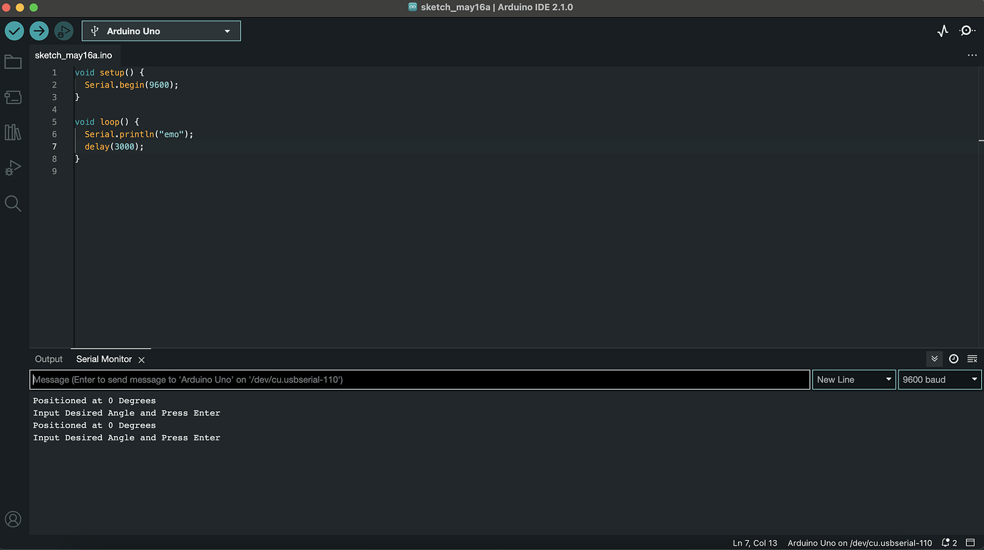

This is how my serial monitor looks like.
The code displayed on the image (emo) is not the code in the code block (servo). Your servo code works (this link is a simulation).
Perhaps you need to click on the blue arrow to upload your emo sketch to your Arduino.
I tried to upload many codes on arduino after servo code but serial monitor still displays the same thing that i showed in the picture. It stuck no matter what code that has been uploaded.
The only code that you can upload to your arduino is the code that you see in the IDE (your picture).
To upload different code to your arduino, you must open that code with the IDE, then use UPLOAD button or SKETCH >> UPLOAD or CTRL-U.

Then I uploaded it to my arduino board to test it then I detached my servo motor so I can use my arduino board for some other project. I write other codes after and uploaded it to my arduino. For example this code
Serial.begin (9600) ;
Serial.println("emo");
delay (3000);
The code I uploaded is not important because the serial monitor always displays following
I tried uploading other codes but the serial monitor always shows that.
To sum up, no matter the code I upload to my board it always displays the serve motor code's outcome.

I did click there but it does not work. Serial monitor acts like the old code is still running but i uploaded my new code.
I can upload any code I want so uploading does not fail. The IDE shows that my code is uploaded in arduino board but it does not work.
I use IDE 2.1.0 and it does not give any error messages when uploading. It uploads my code on arduino but I tried IDE 1.8.19 after writing my problem to this forum and it gives me verification error content mismatch.
Your board retains the uploaded program when power is off, as you show it keeps working whenever power is applied.
Is it possible that your usb cable is good enough to make the IDE happy and show output, but bad enough not to successfully upload... or could the logic on board not be functioning correctly during upload... or something else.
Try another cable, arduino, computer.
