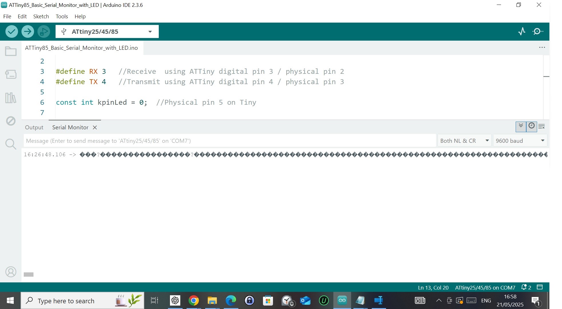

I have not been able to get the serial monitor to show data transmitted by the ATTiny85 as I need it to continue with my projects:

  • Uploaded the sample sketch using ATTiny physical pin 3 as transmission pin.
  • Connected ATTiny physical pin 3 to Arduino RX / 0 - just a continuous line of "?". The baud is the same in the sketch and serial monitor and the TX LED on the Arduino is flashing regularly.
  • Swapped USB cables.
  • Swapped Arduinos.
  • Changing the baud rate, up or down, only changes the character displayed.
I think I have proved the Arduino Uno is okay and the ATTiny85 is okay and that I am using the correct Transmit / Receive pins.
I have tried many different sketches from many different sources and keep getting the same result.
Does anyone have any ideas please?

Thank you for getting back to me. The sketch is uploading to the ATTiny okay and it is doing what it is supposed to do. The issue is that I cannot get useable information on the serial monitor. I have since done a loop back test on the Arduino and didn't get anything back so it looks like the RX side is u/s although using the serial monitor from the Arduino is okay. Is it possible to use an alternative I/O port for Receive instead of the RX / 0. If so, how do I configure the Arduino to accept it? I am using the Arduino Uno R3. Thank you again for your help.
