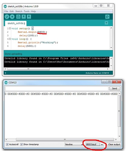

Serial monitor only prints out weird characters
Check the baud rate at the bottom right from your monitor if the same with baud rate declare in your code Serial.begin(...). The differences maybe cause of weird characters

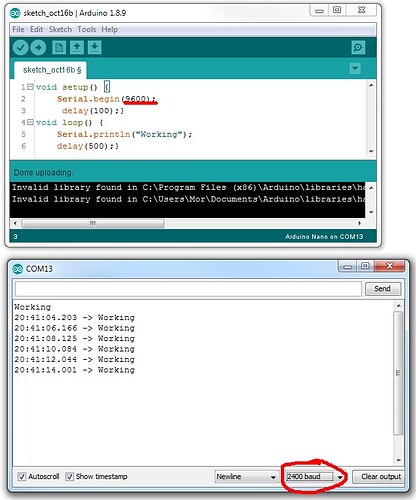

i have same problem (using massduino MD-328D) , weird characters in serial monitor
code upload is ok and working but serial monitor is not ok...
i found, that with dfiferent baud rate is serial ok...
i upload code with baud rate 9600 but serial monitor works correctli with baud rate 2400... why so??
