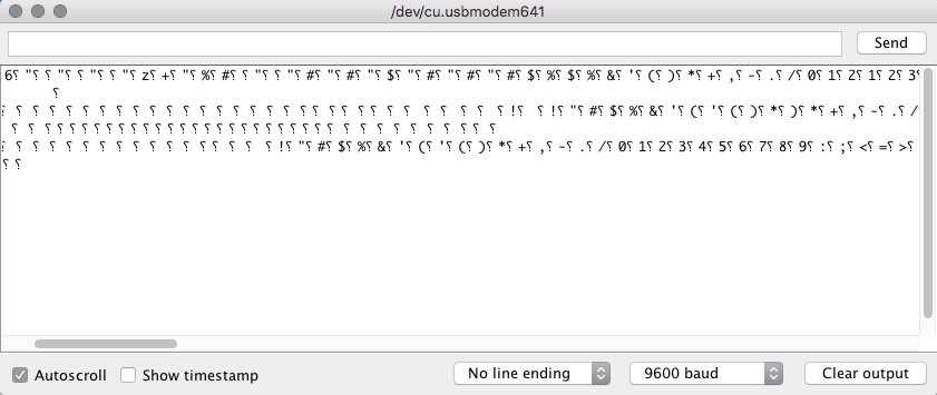

I've been trying to build my own MIDI controller for the past days. After binging through many tutorials I came across a helpful one and followed it step by step. Unfortunately my serial monitor is printing weird symbols lately. I tried writing everything again from scratch and copying the code from the tutorial website, both did not help.

a screenshot of my serial monitor is attached
why are you using write() instead of print()/println()?
check the speed rate for the serial monitor matches the rate you are sending at
