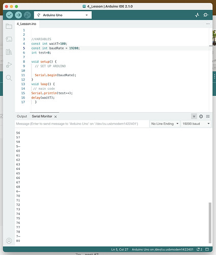

Complete newbie. I’m having a very strange issue with the Serial.print function. My Arduino will not print the number 9. I get a dash in place of the character 9. Using just a simple counter that increases by 1, you can see the print output below. I’ve tried all kinds of tests, and no matter what the number the “9” is always replace by a “-“ when it prints. Seems like a weird bug, but everything else has worked just fine so far, and it is doing the math correctly. Same thing happens whether the "9" is an integer or a character within a string.

Same issue:0-8 fine, 9 = "-"
Nothing at all is attached to it.

This is weird.
Try to print exactly '9' or hexa next to each number.
Something with terminal setting or terminal itself? Try PuTTY or some different terminal emulator.
Character nine is tab. I have had problems with this a very long time ago where it confused the hardware I was using. I doubt that this is your issue, but another terminal program would be worth using for testing.
For some reason when using baud rates over 19200 I don't get a visible print. But this is your code using 19200. Same issue.

Weird, right? Is it possible I have a faulty Uno? Or a bug in the Mac Arduino IDE software?

Do you see the same behavior with IDE 1.8.19?
What happens with baud rate 9600?
I only have the latest version. I will have to try to get an earlier version to test. I'm new.
Baud rate doesn't seem to matter -- same thing happens.
Looks like this is the issue. v 1.8.19 works fine! Hopefully this will get fixed in the latest version.
