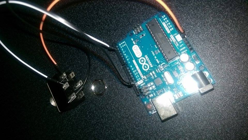

Serial.print once in a void loop?
I have a toggle switch and want it to act like a button. When the switch is on, the Serial.print, rapidly prints it and when it's off, nothing happens. But I want it to print once when the switch is on.
Thanks

Sadly neither of the replies worked. Just to clarify, when the switch is up, I want nothing to happen, but when its flicked down, I want it to give my computer an input, like a keyboard. And when it's flick back up I want it to give the same input.

Sigh... I'll try some mind reading here... you want it to register a key event whenever the switch is toggled, regardless of whether it is currently up or down?
As in... the switch is down... I click it up, it says, "hey, the switch moved". I click it back again, it says, "hey, the switch moved"?
Yes, that's correct but it only says "hey, the switch moved" once, sorry if it wasn't clear. Thank you

Nope, =/
What is it not doing?
I edited the code to suit my set up, and it's not outputting text.
You do not need the +5 volt connection on the switch as the internal pull-up resistor is enabled.
I assume the wires are soldered at the switch terminals.
Using the sketch I attached, tell us what is happening on the serial monitor when you flip the switch in one direction then the other.
Using my code I commented earlier:
Down position - "On" appears
Up position - Nothing when flicked up
Using the Arduino Debounce script:
Nothing.
Sorry if this isn't what you asked for.
