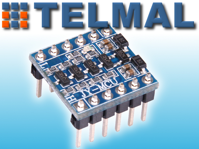

Which level shifter do you have, and how is it connected ?

The level shifter is same as on this picture. How is it connected - its two directional bus, so TX and RX are connected straightly, two grounds, to grounds, and Arduino Vcc to 5V, and 3.3V ( from my resistor divider ) to 3v3 :slight_smile:
Converter link

I think your level shifter is for a open-collector bus. It has mosfets with a weak pullup of 10k to 5V (or 3.3V).
I'm not happy with using that for high data rates. It is not a logic chip for digital signals.

What is the value of the resistors for the voltage divider for 3.3V ?
