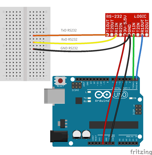

The rs232 pin out i am using is similar to this except i am using pins 6 and 7 instead of the default 1 and 0 for rx and tx:

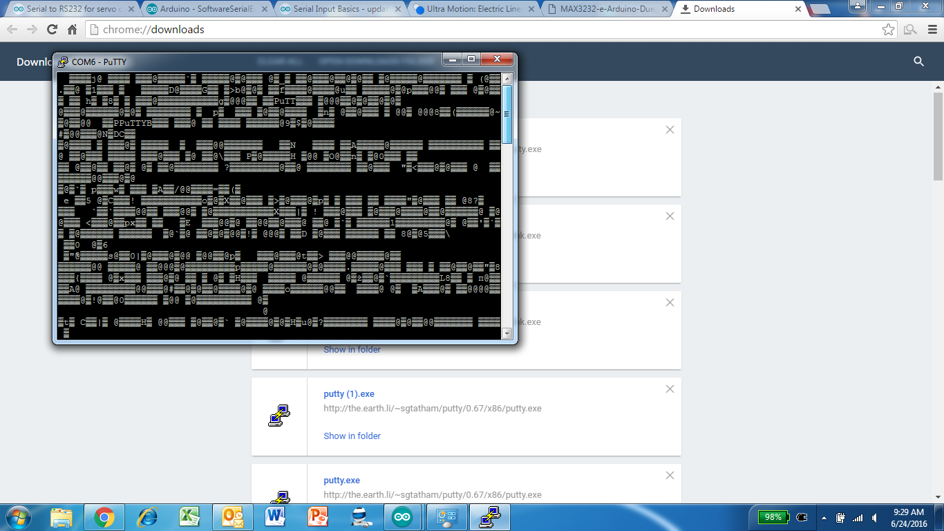

When i upload the code that the manufacturer gave me and i output it to PuTTY the following is what shows up:
The code that the manufacturer gave me did not work when uploaded to the arduino and put through the max3232 circuit that i am using to step the voltage up to rs232 levels.
Your code uses software serial on a hardware serial port and it uses hardware serial. That will never work.

Hook pin 1 of the Arduino to T1IN of the MAX232. That way anything that is echoed to the PC via USB will also be echoed via the MAX232. You need GND as well.
Hook the MAX232 via the RS232-to-USB to the PC. Anything you type in putty connected to COM4 should show in putty connected to COM4 and in putty connected to COM5 (using the numbers you used).
Next disconnect the RS232-to-USB cable and connect the MAX232 to the actuator. If the previous test indeed showed data on COM5, the actuator should now work.

I'm not sure if this is true but i thought you weren't able to use pin 1 and 0 while also having the serial connection open and that is why you have to emulate them with other digital pins.
Do not connect the R1OUT of the MAX232 to the pin 0. The USB converter on the board and the MAX232 will fight each other.
So one more step back now to make sure that the usual communication via USB still works. Only connect the USB on the Arduino to the PC, remove all other wires from the Arduino. Use putty or serial monitor and check if you get echoed messages (send and you should get TA back).
Working? If so,
Connect GND to the MAX232 board and Arduino pin 1 to the T1IN pin of the MAX232 board. Also connect the 5V; so it's like the picture in your reply #4 without the connection to pin 0 of the Arduino.
Connect the RS232-to-USB to MAX232 board and the PC; keep the USB between Arduino and PC as was.
Run the code again with two putty sessions; send in the putty window that is connected to the Arduino USB. Both putty windows should show TA.
You can use pin 1 (TX) as many times as you want (OK, within limitations due to maximum current); RX is trickier because the one sender might want to keep the pin HIGH while the other one wants to pull it LOW (start condition). The USB chip on the Arduino is protected by a resistor to limit the current when that happens.
It will not allow me to open both serial terminals at the same time it always takes away the arduino connection and only recognizes the USB to RS232 connection. For instance it will allow me to keep the arduino port open ill upload the code as soon as i go to hit serial monitor it immediately takes the arduino off of my devices list. I am trying to solve this problem now.
You should be able to use 2 putty sessions on different serial ports. You can also use two serial monitor sessions, but it's a bit tricky. The below works with IDE 1.6.6.
Double click your sketch (ino file) in windows explorer. This opens the IDE. Select the serial port and open serial monitor.
Double click another sketch in windows explorer (it might work with the same sketch but I have never tried that. You now have two IDEs open and they are independent. Select the other serial port in the second IDE and open serial monitor.
Sorry for the overdue reply. I couldn't get this method to work so what i did was uploaded the following code to see what i got:

This allows the arduino to keep writing the code to the serial port without me needing two windows open since i can now power the arduino via the Power Jack. After doing this test i got the following result on my PuTTY screen: (See attached image)
Im assuming this means that my circuit is actually wrong. But i am unsure I will be trying to troubleshoot further thank you for the help in advance.
