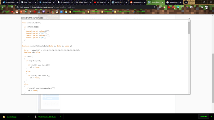

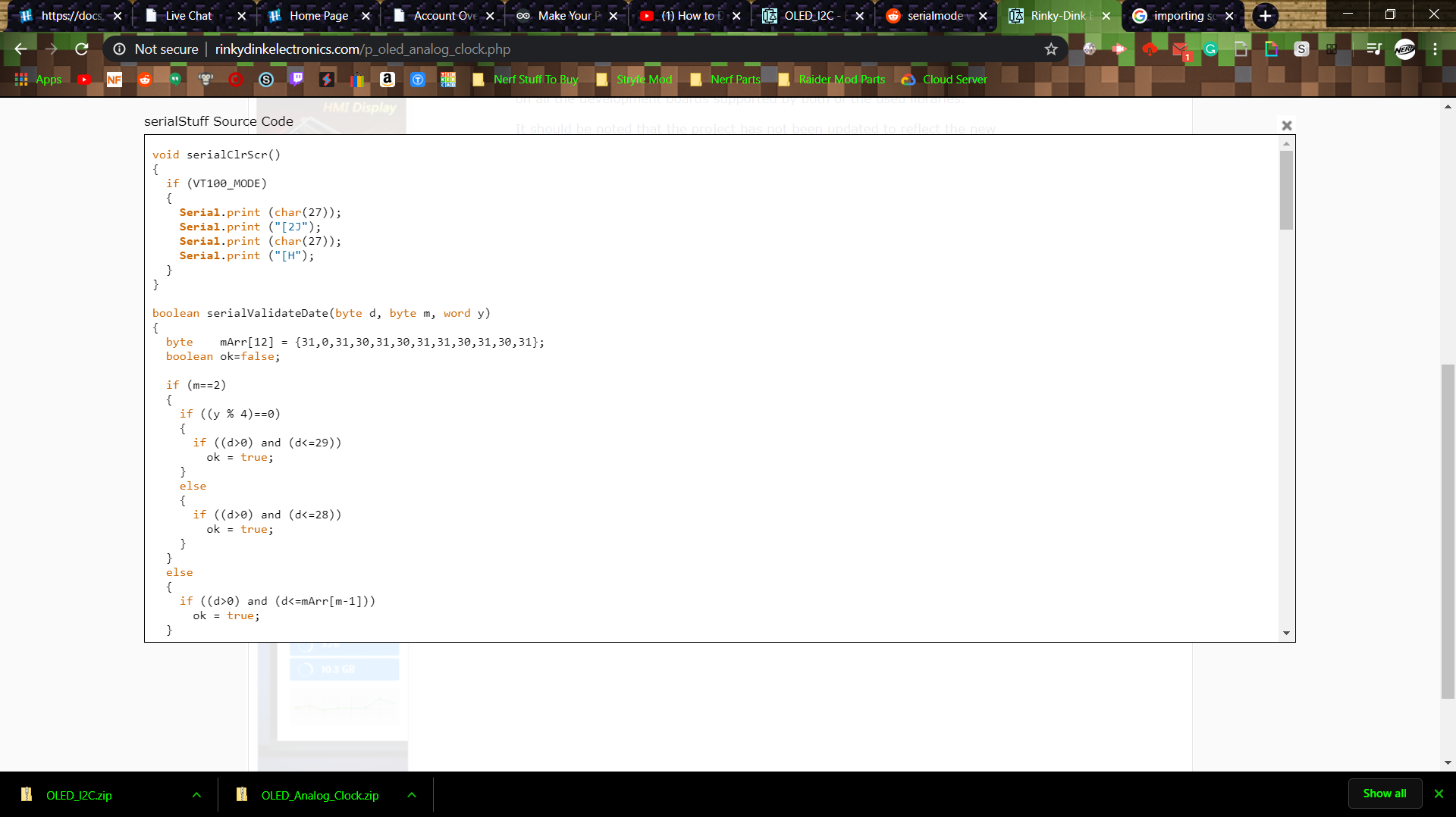

'serialMode' was not declared in this scope
I'm making an OLED clock. I've tried getting serialStuff but it's not a library to download
I've tried everything. HELP!!!

mememan123:
Post a link to where you got the code from.
Your program is calling a function called serialMode() but it does not contain a function with that name.
...R
what is "serialMode()"?
Serial.read() reads a char when Serial.available() is true
