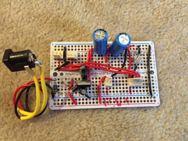

Can I ask the obvious question?
How are you powering the servos and do you have enough power to supply them.
Can you please post a copy of your circuit, in CAD or a picture of a hand drawn circuit in jpg, png or pdf?
Tom...... :slight_smile:

Yes, I can show you, but I have been very thorough in troubleshooting to narrow the jitter down to the millis() timer.
I am using a 12v 2amp source
Hi, good, what value are the two blue electros and where are they connected?
What spec is the servo and how many?
Have you written a simple sketch using a Servo library?
