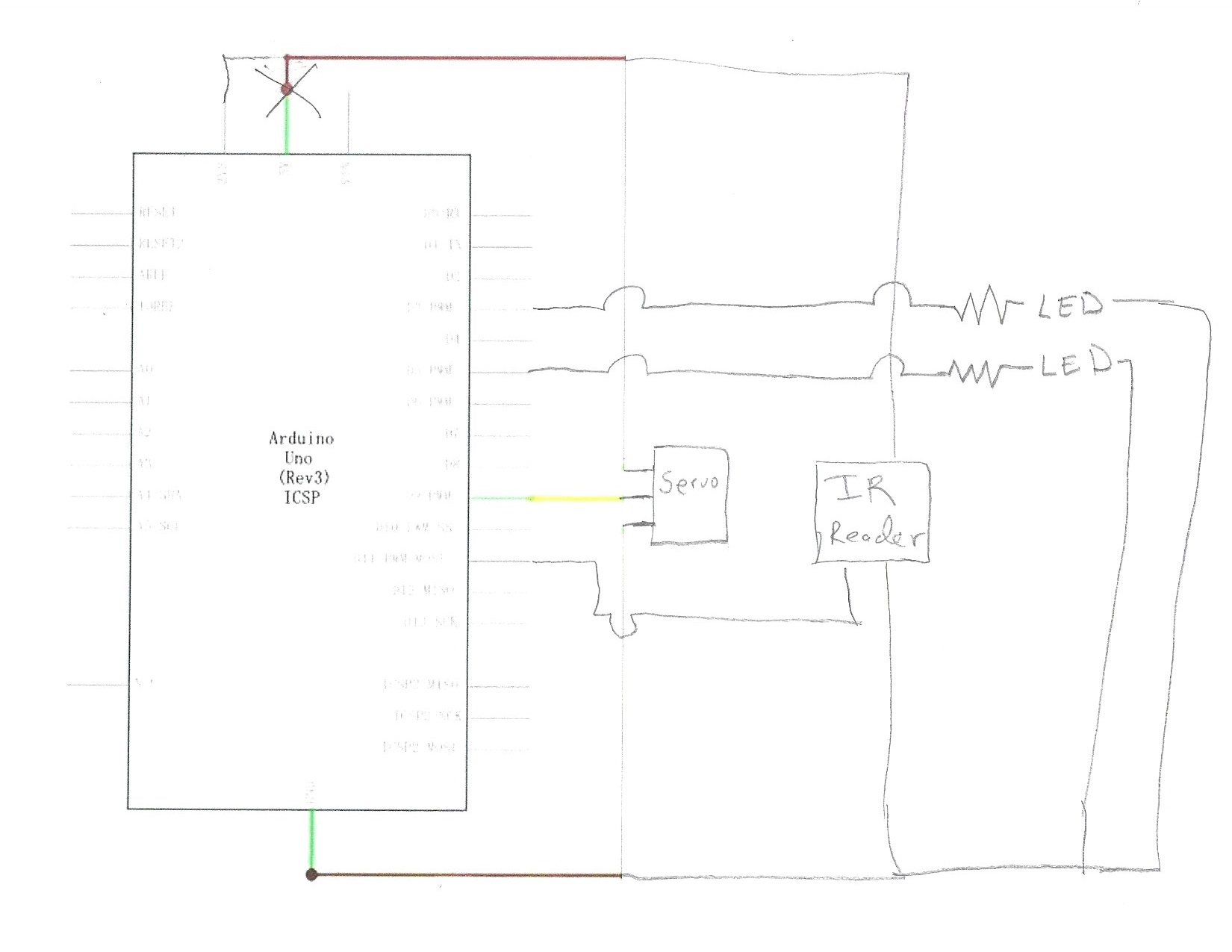

Hello and thank you for reading my post. This is about the reliability of servo motors when attached to an Arduino board. I have recently helped my kids with an Arduino project. The trouble is that the servo motor is not consistent in activating when the event that activates it occurs (IR signal). Sometimes the motor will get electricity triggered, make a funny clicking sound, and then not move. This occurs inconsistently. I was wondering if this is most likely due to things such as a bad connection in the board, a bad servo motor, or perhaps I just have too many items attached to the Arduino board. (I have attached to it 2 LEDs, the servo motor, and an IR sensor. Could this be confusing the circuit in some manner?) I am not that familiar with Arduino although I have gotten this configuration to work very well in terms of its basic functionality. Often, it all operate as planned, with the exception of reliability. Sometimes the servo motor just doesn’t work properly. I do have numerous other servo motors and and also Arduino boards. I can try mixing and matching. (Although I have tried 2 other servo motors and get similar results with each.) My next step would be to solder the wires together that connect the servo motor to the three ports on the Arduino board. But before I started soldering I wanted to run the situation by those on the board and see if this is typical or if I may have missed something in the diagnostic. Thank you in advance for any help.
How are the servos powered? Hopefully not from the Arduino!
Provide us the code using code tags (up to the left in this window) and attache a wiring diagram, pen and paper could do. The way You power the different parts is quite interesting.
Hi thank you for your responses.
Yes I have all the accessories connected to the board - the 3V for power; the GND for ground/return; and then 4 of the pins for signal (power for the 2 LED's).
I don't really know the Arduino very well. I just got this to work by reading the tutorial sections about LED lights, an IR reader, and a servo. I took those 3 different kinds of diagrams (each of which has the individual accessory with all its pins connected to the board, and then I just merged them all together into one solution.
The hand-written diagram is attached. (are you finding this readable?)

The way the power goes to this configuration is a USB connection onto the Arduino board. It's and A-to-B USB connector. I then plug the USB cable into an Anker brand, wall-outlet powered USB charger.
(someone else posted that they said they were hoping I didn't have this powered through the Arudino board … I just am not sure which connections to what type of power source need to be made in order to avoid that since all the examples I created have each accessory fully connecting to the Ardino for power, signal and ground...)
Thanks again for your help!
USB might not provide current enough for Arduino and servos. Check up that supply.
Thank you I will have a look. How would I get more current to this configuration? Is there a way to power a servo separately than from the board? There is also a barrel connector that I can use to power the board with a 9V batter but this didn't work at all. I have a bit of a background in electricity but very little practical experience (and my intuitive grasp of it doesn't got much beyond reciting V=IR). If you tell me just approximately what to do to send power in a different manner and about what sort of parts / batteries/wires/power supply, I can search it up and wire it.
Thank you!
Check the specs for the servos. What current do they use? What is the stall current? Most likely You need a separate and better pwr supply for the servos.

Don't use those 9v smoke alarm batteries as they'll get you into more trouble than Flash Gordon.
Servos can pull a lot of current and can be electrically noisy to the Arduino.
Drive the servo's Positive line from 4 AA batteries.
Connect the ground of the above with the ground of a second supply of around 7.4v like a 2 cell lipo battery.
The positive of the Lipo should feed into the Arduino Raw terminal.
The Raw terminal is internally connected to a regulator in the Arduino board which gives the 5V for the board.
The servo signal wire still goes to whatever Arduino terminal.
There are also other configurations.

All I said was you need another battery to drive your servo, preferably 4 AA cells.
For future reference, servo current draw( nominally expected to be close to 1 Amp) is not determined by the size of the servo.
Many electronic devices follow the same routine, i.e. size is not necessarily any form of indicator of current requirement.

Typical servo wiring setup using an external power supply. Servos usually work best at the high end of their operating voltage band.
Thanks all for the input. I think I have a plan now, I've ordered some battery packs.
@zoomkat - in the diagram above, can the remainder of the Arduino board still be hooked up to power via the power connectors on the board itself (ie, the barrel connector or the usb port)? In other words, will that circuit diagram work ok if the servo external power is from a distinct and separate battery is used to power the main Arduino board itself?
Also to all who asked about the spec of the servo - it is an SG90 micro servo motor, it looks like it operates between 4.8 and 6 volts. Does this add the needed clarification ?
Thank you again for your help and any other suggestions !
Yes, You can preferably supply pwr separately to servos and Arduino. Personally I use 5 volt powerpacks, used for charging smartphones, to feed the Arduino itself. Motors etc. I feed by separate and "big" powersupplies.
"@zoomkat - in the diagram above, can the remainder of the Arduino board still be hooked up to power via the power connectors on the board itself (ie, the barrel connector or the usb port)? In other words, will that circuit diagram work ok if the servo external power is from a distinct and separate battery is used to power the main Arduino board itself?"
Yes, just make sure the grounds between the servo power supply and the arduino ground are connected together like in the diagram.
