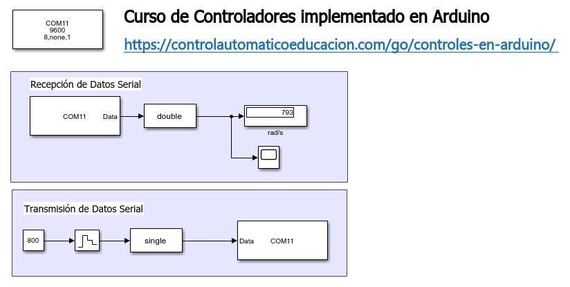

I want to post here once again, I have a serial smart servo motor (provides feedback), when I use this servo motor with arduino serial it works great but when I try to use it with SIMULINK/MATLAB, everytime I start simulation the servo goes to it's initial position 0 once I close the simulation the servo goes again to the max position 300°. please find attached Arduino code :

Servo motor uses Serial 1 to communicate with Arduino while I use Serial 0 to Communicate with SIMULINK.
If you have any proposition I would be greatfull!

tbh not sure how the simulink COM block works but I strongly suspect that it transmits out raw value, ie when you tell it send '20' for example, it sends out the BINARY representation of '20' and NOT the ASCII value (ie string values) of '2' and '0'.
have a look as the ascii table for binary values of alphanumerics if you dont know it already.

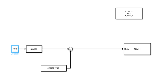

if you still intend to transmit the actual integer value, one way I would do it is,
since 'single' is 4 byte wide and your servo value is not expected to exceed 65,535, I would set the UPPER 2 bytes of your value to 0xFF
so on simulink side I would:
adding a summing block to add 4294901760 (ie 0xFFFF0000) to servo val.
set you transmitting byte to BigEndian with no header or terminator.
on the arduino side
if receive 2 consecutive 0xFF
then if 3rd byte receive should be <0xFF (upper byte value)
then receive 4th byte (lower byte value)
combine 3rd and 4th received byte to get servo position value.
There would be a few more bits I would also add but your original code was a good start! I dont wanna spoil all the fun!
Hi, I tried the described steps but in vain, The servo motor doesn't turn at all, Please correct me if I am wrong, here is the modified simulink code :
