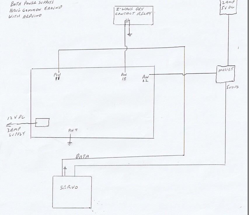

the wire that goes to the servo is a cat 4 telephone wire 4 conductor for about 50 feet there is two runs one for each of 2 servos.
In the scetch the only way the servo is to operate is when the pin is grounded. Why would the run on the wire to the servo matter.
I have removed the arduino and servo from that location to my work bench and I have notice when I attach a volt meter to pin 18 (the pin that is grounded to operate serrvo) the servo opperates Y is that happening
Ive also notice that even when I take a long wire 2 pair 22 gauge still on the wire reel and touch one end to pin 18 the servo will operate even though the voltage does not drop.
I dont understand in the sketch its only to operate when pin 18 goes low (by grounding the pin)

Ok to Railroader for now the servo is 8 inch from the arduino so I dont think the pullup will do anything
I have added my wiring diagram for one servo. Its the same for the other two just using pins 9,10 for data and 19,20 for relay or pushbutton.
Yes it does it on all three pins that are set up as bushbuttons
Like I said I dont understand the servo operating when I touch pin 18 with the lenght of wire thats not grounded

I don't argue against interrupts or not but how are those pins setup within the controller? Pin 18 and similiar. I urge You to make sure that pullups are used within, or close to, the controller. I only use UNOs but You probably use another one.
Sorry Im slow at this. Your saying place maybe a 10kR at the arduino between 5v and the data on the servo or 5v to pin 18 the pushbutton.
Using a Mega
OPs circuit;
I see that you are high side switching the servo supply, what happens if you bypass the MOSFET so the servo is powered continuously?
You are fortunate that the servo supply is 5V as your high side switching will not work with any higher servo supply voltage than 5V.

Attach Your wiring diagram. Maybe You should use "INPUT_PULLUP" for the button inputs. It depends on how the buttons are connected. Free floating inputs will give random activities.
As requested
Ok. You use 10kOhm pulldowns and feeds +5 from the buttons. That is okey.
You feed the servos from the Arduino and that can be hazardeous. What current do the servos draw? UNOs, as I am used to, have a maximum capacity of 20 mA and a destruction limit of 40 mA. Overloading the outputs can possibly cause strange things to happend.
If You use the code I sent pressing button 2 should activate servo2 and nothing else. The same for button1/servo1.
Sorry, I made a mistake. You use the Arduino 5 volt for the servos. How is the Arduino powered? By a 7 - 12 volt? In that case maybe the Arduino 5 volt converter is owerloaded. If powered by the USB the same applies, maybe the servo overload the USB power aource.
I just have one servo connected to a mega. If I can get this problem fixed my intent is to have an another pin go high when any of the buttons are pressed and this will control a mosfet and in turn power the servos from an outside sorce. Right now the mega is powered by a usb cable from my computer. That I dont think should be my problem. Right now I just have one button connected to pin 2 it will control servo 1 on pin9 if i move servo data wire from pin 9 to pin 10 and try button 1 the servo will operate and it shouldnt
