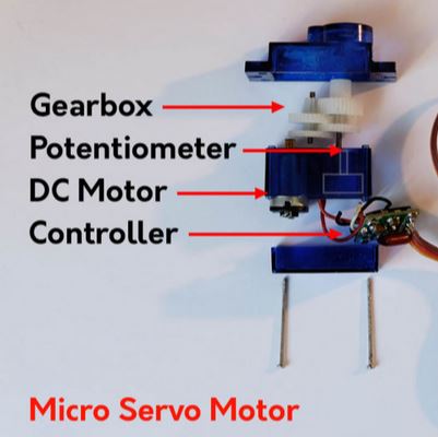

Can I convert a servo motor into an angle sensor. My logic is that the servo motor must have an idea of where it is pointing, so can I read this value and print it to the console. Thanks in advance
Inside the servo, a potentiometer attached to the servo output shaft gives a direct readout of the servo arm angle. You could take the servo apart, remove the controller and motor, and read out arm position (the pot value) using an Arduino.

So I assume that my hypothesis is correct. Is there a way to read out the angle in code ( I don’t need full 360 degrees, I just want to know where it is pointing, so for a servo motor that turns 180 degrees and I manually rotate it to point in the middle, the code should read out 90). Also is there a method to do this without purchasing anything

function. Rather than randomly guessing the angle, I want to manually rotate the servo motor’s spiny thing to point wherever I want and then read out the angle so I can input that angle into the servo.write of my actual code. I was hoping for a way to do this without any extra equipment except for the servo, arduino and wires(duh)
Instead of brute force, try making measurements and use simple geometry to estimate the required servo arm angle. Some servos can be destroyed by manually forcing the position.
To read out the arm position as I described above, the servo has to be disassembled and modified. It won't work as a servo without reassembly.

I do not agree because in my experience when I manually rotate a servo to point in a direction then tell it to point somewhere else via code, the function is aware too where the servo is pointing and it turns accordingly. If somewhere in the inner workings of the Servo.write() function it is able to read the angle of the servo motor, then why can’t I read it

The servo class returns the last value written to the servo and don´t reads the pot of the servo back.
the signal to the servo is one way
there is no way to read the current servo pot position without additional hardware
No, it is not aware of anything. The function sets the output pulse to the servo to make it go to a certain angle; all the servo electronics "knows" is that the servo is not at the right position and it moves it towards the correct new position and stops when it gets there.
The Servo can say where it is, but all that can tell you is what you told it to go last time… the software has no idea where the servo is positioned. It can't even say that there is in fact any servo attached.
I don't think it would be especially hard to open the servo and grab a lead off the wiper of the feedback potentiometer. It will def have a value between 0 and 5 volts, assuming a five volts power supply, and whatever you read will be in proportion to the angle you've twisted in.
Read the voltage at the wiper of the feedback pot with analogRead().

you could wire the Arduino to the pot in a servo with the motor removed to measure the position of an externally moved servo arm
