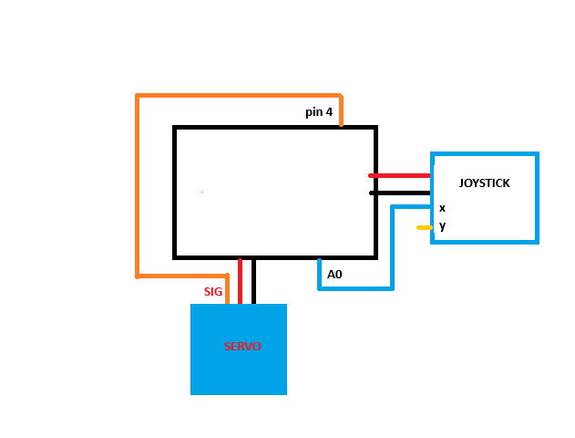

Hello all.
I am trying to control a servo with a joystick.
The following code worked great with the x axis . I would like to add the y function to control the servo at a slower speed. X at current speed and Y at a slower speed. Can someone help me please. Its just a one time project to control a tunning knobe from a distance . Here is the code I found on a forum.

What do you mean? The servo moves as you move the joystick.
You control the horizontal. You control the vertical. You control the speed.
a7
I understand you want to use one axis of the joystick to adjust movement in a direction and another axis of the joystick to adjust the speed of the movement.
However; the 360 servo control is one dimensional - a value, a pulse width - that increases or decreases. When the value decreases toward the minimum pulse width, the servo rotates counter-clockwise at increasing speed, and when the value increases toward the maximum pulse width the servo rotates clockwise increasing speed. Also, the properties of a joystick returns the stick to center, which would be a "stop" value for the pulse width, and the servo.
But, you could use one potentiometer for speed, and a button for direction. Your code must stop the servo momentarily before changing direction.
Your code only sweeps a 360 servo between stop and medium speed.

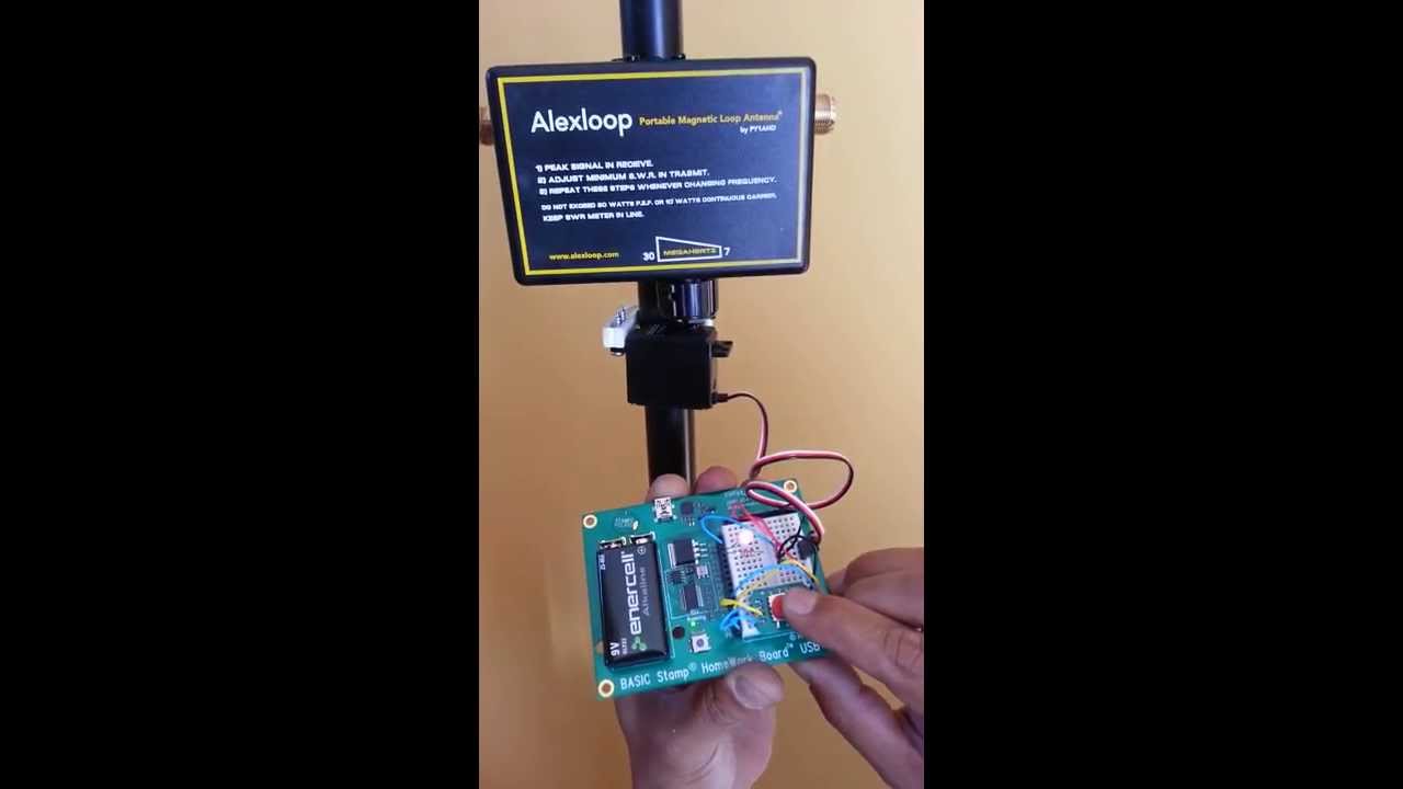

Thank you so much for the response. So I had a Parallax Basic Stamp 2 quite a few years ago. I used this idea to move a knob on a part of a antenna. Servo moved the knob via friction. I posted it on YT years ago .
X ( Up / Down ) moves the servo one way at Speed 1 lets say. Y ( left / right ) does the same as x but at speed 2 ( a bit slower than speed 1 ). Used to fine tune the knob.
Cant figure out how to do it with Arduino though Im close ... LOL
Thanks for your help.
Joey

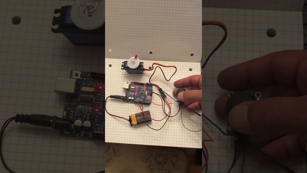

Hi alto777.
Thanks for response. My apologies to all for my very minimal knowledge of programming.
So the video shows a Joystick on the Basic stamp 2 board controlling a servo.
I wish I would have saved the code but that was like a decade ago. I never saved it.
The following code I found in the internet works great but only in the x axis ( up / down ). Using the following code with joystic at up direction the servo rotates one way and will continue rotating until i release the joystic. With the joystick at the down direction the servo rotates in the opposite direction until i release it. Speeds are equal each way. That is exactly what i desire to happen.
What i would like to add is the left right ( y ) of the joystick to do the same as X but slower.
I really appreciate all the views and responses . Your time is valuable.
I actually dont need the Y function just wanted to try to add that feature.

Ok, we all maybe in the same page now.
This
1000 + analogRead(JoystickInputPinx)
is 1000 (don't be moving) or 2023 (move like a rabbit) depends on the switch.
So this
1000 + analogRead(JoystickInputPinx) / 2
would give you 1000 and 1511, stopped and moving slower.
This
int XX = 500;
digitaRead(JoystickInputPinx) ? 1000 : XX;
would let you adjust the speed 500. Lower slower.

Hello again everyone.
Here is a 15 sec vid of the circuit.
I just want to add the y of the joystick to control the motor slower than the way the x control does.
Here is the code that works with x and shown in video.
