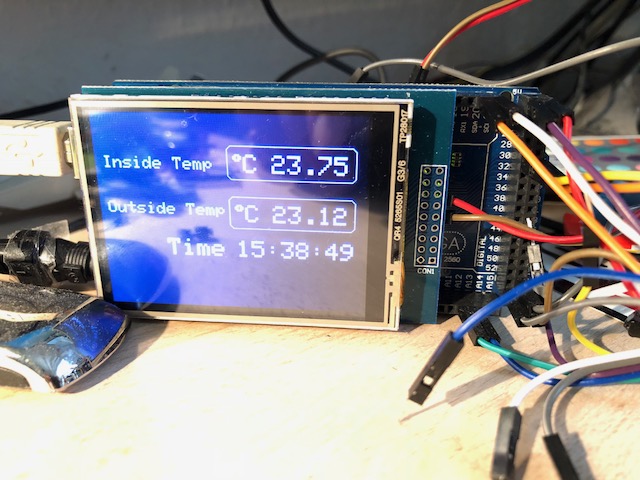

I am trying to make a beer brewing controller and am getting stuck on connecting the rotary encoder to any other PIN than I can find in posts or references online.
Tried pinMode, all sorts of available free PINs,etc. to no avail.
The thing is, I'm using a 2,8" TFT with shield which occupies PIN 2 and 3.

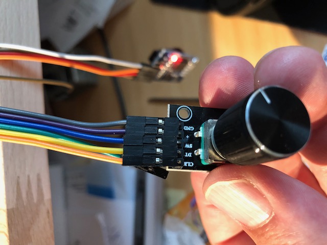

I cannot figure out how to connect the CLK and DT pins from my rotary encoder.
When I use pin 2 and 3 together with the sample code as below it works fine:

I will add a picture of my Arduino board showing the issue with the small selection of free pins.
Connected and working are a RTC and relay board. Maybe I can use other pins for these and free up the ones for the encoder that work (only with the encoder)?
Any hint is much appreciated.
Thanks in advance!
Your pictures are just about useless. Post links to the devices, where the manufacturer knows how to post useful information, like schematics, and which pins are being used.
That code uses pins 2 and 3 because they support external interrupts. The Mega has other pins that support external interrupts, too.
