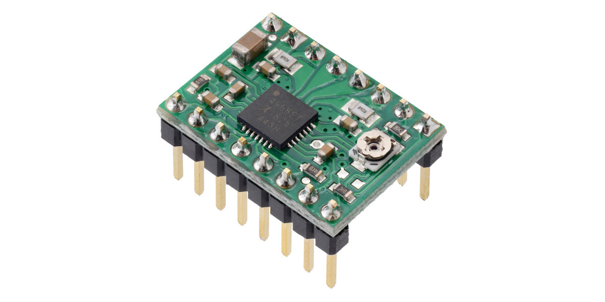

Post a link to the stepper driver you are using. Typically, a stepper driver simply needs to have its step pin set HIGH then LOW to make the stepper step. Doing that with PWM is not the way to do it.

I am currently using this:
You are right, I simply need to turn high and then low for each step, the problem I have is doing it at the correct frequency, especially when the arduino is also doing other task.

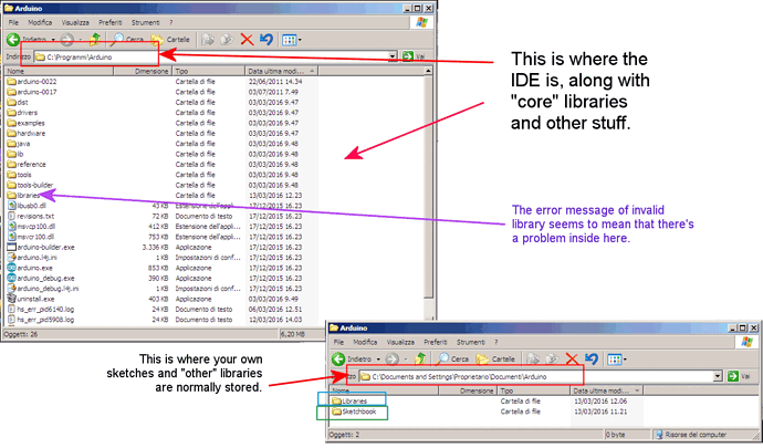

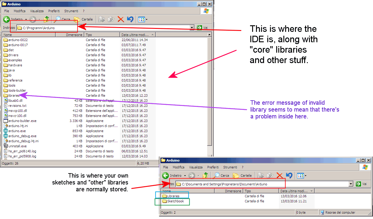

This may help: I've found out that the message almost certainly has nothing to do with the program just loaded. It seems to be a background monitoring thing which looks in the sub directories of the Arduino IDE to make sure core third party (but Arduino approved?) libraries confirm to their standards.
Have a look in the directory where the Aurduino IDE EXE is installed...

I imagine, but don't know, that Linux Arduino stuff is organised in roughly the same way as on a Windows PC. there are two main directories, where "the program is" and where your own sketches and other third party libraries are stored. If you put a library inside libraries (purple arrow in the image) then I think that is the cause of the
Invalid library found in C:\Programmi\Arduino\libraries...
message. Here's an example on an Italian XP system...
dear giovanni,
thanks, you are right, the directory structure is similar. But what I don't understand is how this can solve the problem of the library not loading? To use the library I need to place the library inside the libraries folder, and because the library has some incompatibility with the new IDE, it doesn't load so the program gives an error and arduino IDE issues the message of invalid library.
