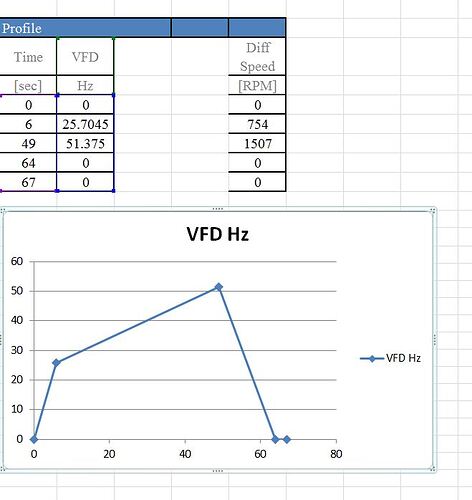

Hi all,
I am using an Arduino Mega to control a Variable Frequency drive that drives a motor. The VFD accepts a 0-10V PWM signal to run the motor between 0 and 60Hz. I build a circuit to make a 0-10V PWM out of the 10V output voltage of the VFD, controlled by the Arduino PWM. Here's the code I have so far:

So, I need to run the attached profile with it. What's the easiest way to set a profile on the arduino? I couldn't find anything in the whole WWW.
Profile ? please explain.
A profile for a certain rpm by a certain voltage.
Or a profile for a certain smooth change in rpm at a certain time.
You want to put the points in from the graph and get a function that gives you the line?
Hz = F(seconds);
Kind of thing?
-jim lee
Like this for example?

yeah, that looks right. So, I just need a function that sets it to the output now.
Well I can help with generating the output from a set of points, I'm thinking someone else will have to help you on the actual output bit.
-jim lee
The multimap is simple : Arduino Playground - MultiMap
It interpolates between the points.
If you want a certain mathematical curve, you should first know what kind of curve. Some go through all the points and others don't. But for now I suggest to start with the multimap.

That is linear interpolation ?
Those values should be in an array. And the multimap can get the value out of the array with linear interpolation.
Yes it is. I read the multimap explanation twice now, but it's hard for me to use it for my problem. All the examples use an analog input as one array. But I need a timer for that. Anyone has experiences with such a problem?
At the bottom is a FmultiMap for floats.
You could rewrite the 'in' array for unsigned long, or set the time in seconds in float, and convert the milliseconds to seconds in your sketch.
float t = (float) millis() / 1000.0;
