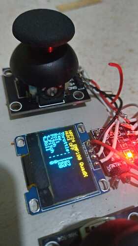

I've been building a NRF24 Transmitter for my Multiwii 2.3 + NRF24 + BMP180 Drone. Everything looks okay, but when I want to test the NRF24L01 transmitter, I see from Serial Monitor and Mini LCD, It shows 127/128 value for Throttle. Therefore, when I arm the drone and, as soon as I release the left stick (it goes to middle-center position = throttle 127/128), the motors start spin 50% or 127/128.
This is what makes it 127/128:
data.throttle  = mapJoystickValues(analogRead(A0), 12, 515, 1024, true );
And, this is to config the mapjoystickValue:
int mapJoystickValues(int val, int lower, int middle, int upper, bool reverse){
  val = constrain(val, lower, upper);
  if ( val < middle )
    val = map(val, lower, middle, 0, 128);
    val = map(val, middle, upper, 128, 255);
  return ( reverse ? 255 - val : val );
But, I have no clue, how to modify it.
WHAT TO ACHIEVE:
I want the throttle value go to 0% or 0 or 1 or 10 (even though the left stick is at middle-center position.

Perhaps necessary:
Source: https://www.youtube.com/shorts/cfkqHvwNXHw
Analog Joystick I use now:

What I want is that the value of min throttle is not 127 but 0 (at the middle-center stick position).
(Of course from middle center to the bottom will have no any values or unused).
OK, so I am waiting for my ride to the beach, but confirm:
Any joystick now feeds 0 .. 255 over to the flight control software. Or at some point in the chain it is in that range, which comes due to full travel in the stick.
So for you toy joystick, you want 0 to halfway to report 0 (no throttle) and from halfway to full it shoukd report 0 .. 255.
I'll take what time I have to look into it. Glancing at the code suggests this should be easy. I'm sure that even without knowing the details, someone might spot where to place a fork and knife and poss a spoon in the code to force that to be the case.
One thing to know about the map() function is that it will happily extrapolate, which is why it often appears close to calls to another useful function constrain(), which can be employed to keep values in the r angle where they have meaning.
L8R
a7
wait, okay. I will have a go at it again.
1. You said about range based on the joystic characteristic:
  • min throttle: 0 (not 127)
  • mid throttle: 192
  • max throttle: 255
2. You said about constrain() and map() and I think I must re-write the code specifically for the THROTTLE. Here it is:
int mapThrottleValues(int Throtval, int lower, int middle, int upper, bool reverse){
  Throtval = constrain(Throtval, lower, upper);
  if ( Throtval < middle )
    Throtval = map(Throtval, lower, middle, 0, 192);
    Throtval = map(Throtval, middle, upper, 192, 255);
  return ( reverse ? 255 - Throtval : Throtval );
3. You said about "where they have meaning" and I decide to change the data.throttle in void loop() as follows:
data.throttle = mapThrottleValues(analogRead(A0), 2, 128, 518, true );
DONE SUCCESSFULLY and Tested!
Here's the screenshot!
s
I also push down the stick and it gives me 0 value.
Then pushing up to the max throttle, it gives me 255 value.
Finally, the motors not spinning again as soon as I arm and starts spinning when I give throttle up from 2 to 255. :smiling_face_with_three_hearts: :kissing_heart:
Thanks sooooooo muacch!

One odd number you wrote was 192, which I do recognize as halfway between 256 and 128, so I'll figure that out on my own, NP.
Because… I do not argue with success. Happy flying!
