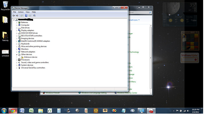

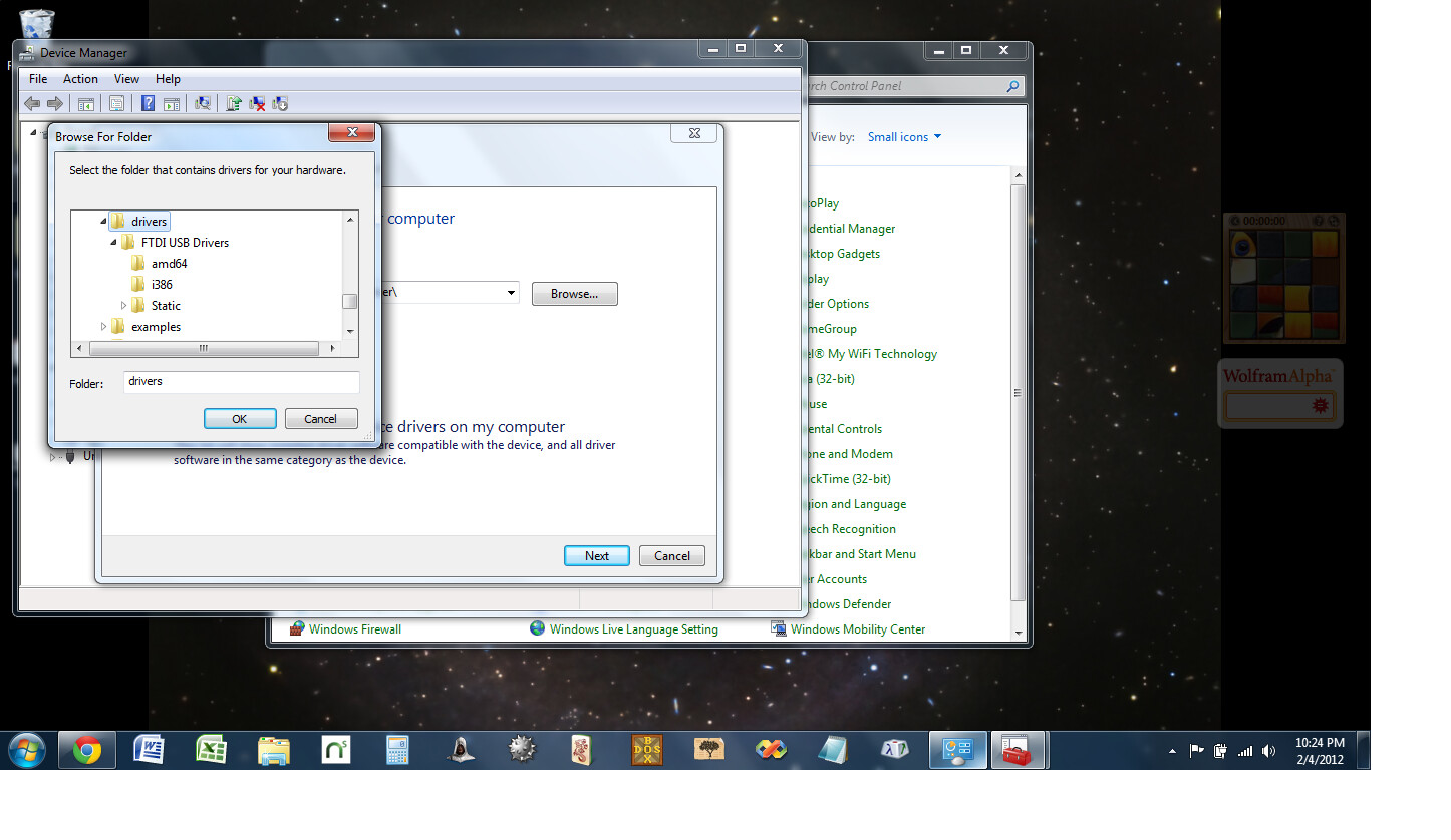

I'm having the same problem and I don't think it's an Arduino hardware issue. There simply is nowhere to choose which port (attachment 1). When I right click on the 'unknown device' and choose 'update drivers', the result is attachment two, which clearly has no 'ArduinoUNO.inf' file to choose. The file does exist if I just open the folder from the desktop and look for it (attachment 3). Any ideas?
Just select the folder. It will know what to do after that.
KirAsh4 - it worked thank you.
Oberling - plug in the UNO via USB > open 'Control Panel' > open 'Device Manager' > 'Other Devices' should have a subheading saying 'Unknown Device' (see my attachment 'Untitled' from above) > right click > update driver > browse for the file location where you loaded your Arduino software > click on 'Arduino' folder > click on 'drivers' folder (see attachment 'driver'). without selecting anything else, click ok. It worked okay from there. You might be interested in a book I found at RadioShack (I know) by Makezine.com called Getting Started With Arduino. Below is the sketch from the book I put in and tested. The yellow LED on board labeled 'L' will blink. Change the values of '500' to whatever to change it. Put a loose LED in at pins 13 (+) and GND (-) and it should work there too. Note that CAPS matter in you code.
