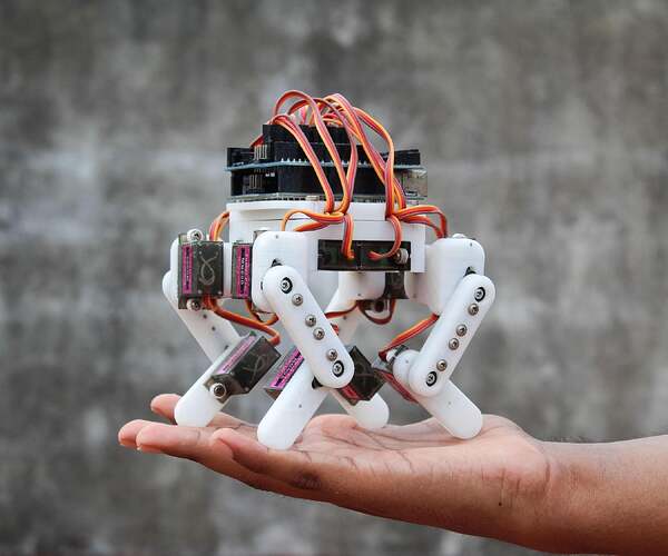

Hey everyone, really new to Arduino here and I've been trying to do this project linked here:
I've made it to Step 10 but it's not working properly. I have 2 problems: 1. the motors are not spinning to 90 degrees and instead go a full 4 rotations before stopping and then continuing again. 2. The code seems to be looping every second. See code below:

Probably power supply not able to handle the motors and causing a brown-out, and the Arduino restarts.

The inadequate power supply is the problem, regardless of the type of servo.

Hi @sebeyza00 .
Welcome to the forum..
Had to watch the vid to see how it was powered..
He's using 2 supplies, USB for the Uno and dedicated supply for the servos..
You would need to remove that jumper and use separate power through the blue terminal block connector for servos..
But yes, agree with @david_2018 , sounds like the servos are not correct..

Do you have a DMM? Digital MultiMeter.
Measure the 5V pin when your problem occurs.
If you are using the computer power supply, it sounds like the 5V is dropping out and the Mega is resetting.
Continuous resetting has the symptoms of as if you are stuck in the void setup() loop.
Tom.. :grinning: :+1: :coffee: :australia:
The Arduino is only for control, not for power for the motors.
The power supply should power the motors directly.
Thank you very much! I see what you mean, the video shows it towards the end. I'll get it connected to a power supply and get different servo motors as well. Just to confirm, there's a recommendation of 1 amp per servo from this article:
Is it safe to assume that for the 12 servos to run I'd need at least 12 amps at 5V?

I also noticed he was using what appeared to be a bench top power supply and I believe it is displaying current usage..
Keep in mind you wont be moving all 12 at once..
Don't see any mention of servo type but I would expect them to be 180's..

Sounds great! I'll get the 180 ones.
Got it, not necessarily 12 amps.
