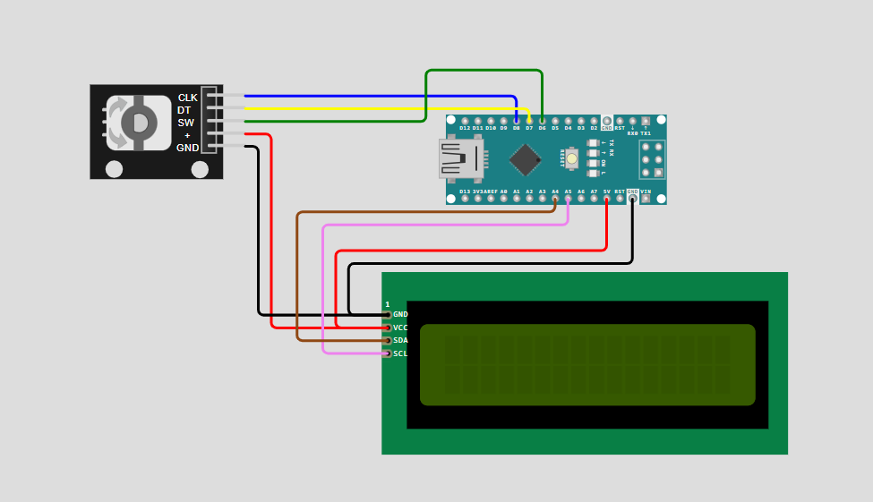

I am working on a project and I am struggling with a starting point. If someone could help with an example that would be great. I am trying to set an INT "speed" with user inputs from a rotary encoder only once in the setup menu. When it is done I would like the program to run this way until the unit dies.
rotation speed is what I am trying to control.
I am using an LCD and a ky-404 with push button.
I want to display "Movement speed?"
speed = 4
as the encoder turns it will -.1or +.1 until it reaches 0 or 8.
after the user pushes the button I would like it to ask is speed 5.2 correct. Then allow for a yes/no from the encoder + number for yes -number for no. If yes then move on if no go back to the previous menu.
If someone has an example of something like this that I could learn from that would be great. I was thinking it would need to be in a while loop but I'm not sure. Thank you for your time.

I can use the encoder I can use the LCD. I am not sure how to keep it from skipping over and waiting for a user input. I think a While loop but I'm not sure. Also I don't know how to send it back. This is what has me pulling my hair out. My issue is I am not sure how to look it up because I am struggling with what to look for.
What type of display are you using?
I2C IIC 1602 LCD Display Module 16x02
Put all your devices in a wiring diagram and post it here. You can pencil/paper draw it, but it must be legible.

I cant Draw...
It looks like you use Wokwi. Click on the encoder, then click the question-mark "?" beside the encoder, and you will be directed to the following page... with a good explanation of the device, and a few example programs.
I found a great example. I have been playing with the code for a bit and I cant get it to increment by (.1). if i put counter -= .1 it wont display anything. I changed the starting counter to 4.1 and it wont display the (.1).

I am certain that Uri Shaked did not present a non-working sketch Check your copy/pasting, and wiring.
I see what you meant... these are not "int" rather "float"
int counter = 4.1;
int result;
int getCounter() {
Change to float... and change your counter++ and counter-- to counter+=.1 and counter-=.1

Is changing it to float all you had to do?
The two variables AND the return type of one function... change to float.
I want you to understand why changing the function return type to float was important... would you describe it so we know that you know?
a float can hold a decimal number. I changed the counter to a float once but I didn't catch the other 2. Thank you
