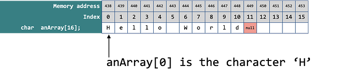

start simple:
  • an array is just a set of contiguous bytes reserved somewhere in memory. The number of bytes reserved is the array size times the size necessary to represent one element of the array.
  • a char takes only one byte.
  • So if you define an array of 16 chars with char anArray[16]; then you are asking the compiler to set aside 16 x 1 = 16 bytes
  • those 16 bytes will be somewhere in SRAM, in the memory. Let's say the compiler decides to set that at address starting at byte N° 438, then it could look like this
  • assume you now fill up the array with "Hello World" with the terminating null char for a proper c-string then the memory looks like this
  • if you want to find what char is stored somewhere in the array, you just use the array notation with the square brackets. The 'H' of "Hello World" is at index 0 so you would find it with anArray[0]. The type of this is char as you are referring to a char type in that memory cell.
  • now if you want to find a pointer to some specific part of that array you use the address of operator which in compiler language is &. The pointer is really just the address where you byte is allocated in memory. So for the 'H' character, if you want to know its address (which would happen to also be the start address of the array) you just write &(anArray[0]). ➜ address of the char at index 0. Here it would be the SRAM memory cell at position 438. The type of this is char * as you are referring to a pointer to a char type in that memory cell.
Now this was done so often in C that the language designers decided that the array's variable name was also usable as the address of the start or the array
so from a programming point of view you can use either &(anArray[0]) or just anArray it's the same thing

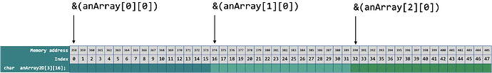

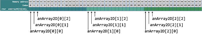

A 2D array works in the same way.
say you want to store 3 c-string of max 15 characters + the null termination. You would define a variable named anArray2D this way:
char anArray2D[3][16];
this secures 3 x 16 x 1 = 48 bytes somewhere in memory, say starting at address 358
it's just a bunch of bytes one after another but from a programming perspective you really have a 2 index entry to the bytes there
and from a pointer or address perspective, it works the same way
&(anArray[0][0]) would be the pointer (the address in memory) of the first cell in memory (address 358) and &(anArray[1][0]) would be the address in memory for the start of the second c-string (address 374).
but of course mentally you can see this as a 2D array arranged this way
where the first index represents the line number and the second index the column number
And again, because this was done so often, it was decided to simplify this and the name of the array would be again the address of the first byte allocated in memory and if you want to find the address of the start of the individual "line" then you can use just the first part of the notation, for example anArray2D[1] is really the same thing as the address of anArray2D[1][0]

so long story short, I'm saying either do
char* pointerFirstcStringArray  = characterArray[0];
or
char* pointerFirstcStringArray = &(characterArray[0][0]);
When you are confused ask yourself about the type of what you write. if you have
characterArray[0][0];
it refers to a specific cell in the array, so the type is char. It can't be a pointer, it's the actual character stored at that location in memory

  1. Forgetting to allow for the terminating nul. strlen("abc") is 3 but it needs 4 bytes to store it.
  2. Arrays index from 0 so char array[2] reserves space for two values array[0] and array[1], but array[2] is beyond the end of the array and could contain anything. Writing to array[2] may corrupt data belonging to something else and result in a bug that could be very difficult to find because it probably won't manifest until long after the faulty code was executed and it can be difficult to reproduce. There are tools that can help but the easiest way to fix memory corruption bugs is to not create them!
Getting your head around arrays, pointers and pointer arithmetic is one of the most difficult parts of learning C. It is also one of the most essential and pointers are extremely powerful. Unfortunately they also provide lots of opportunity for mistakes. C++ is better in that respect because it provides libraries that hide a lot of it.
