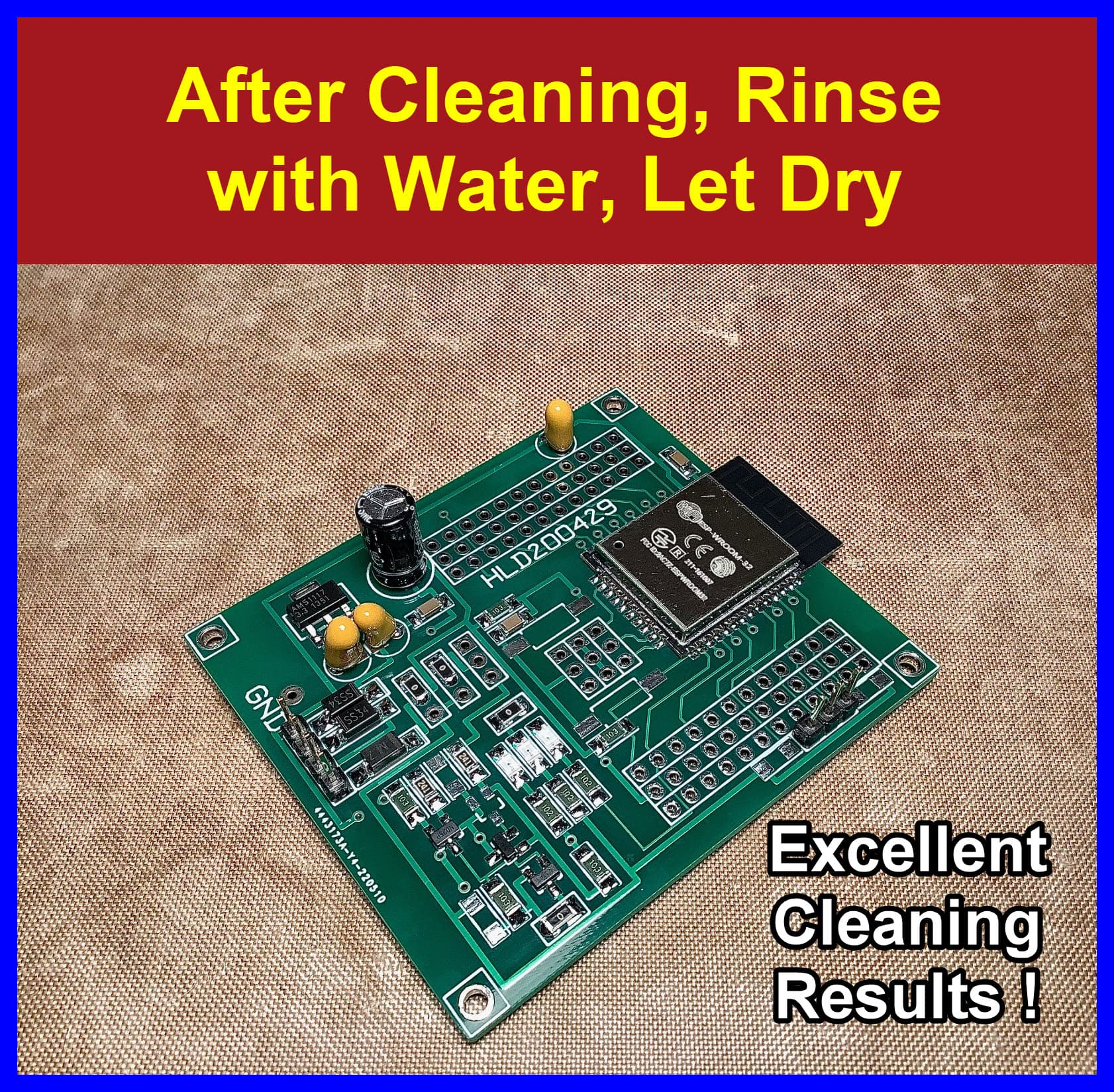

Ultrasonic Cleaning of PCBs
  • If you have access to an Ultrasonic Cleaner, use it to remove all flux residue from your finished PCBs. (follow the ultrasonic cleaner directions)
  • 3L Ultrasonic Cleaning Machines cost about $90.00 to $120.00.
  • A clean PCB is a must for you to double check all your solder connections.
  • I use ~500ml of 50-75% IPA in a Ziploc bag, insert into the machine’s water bath.
    This reduces the amount of solution needed, it can be recovered and used multiple times.
  • Follow the warnings in your ultrasonic machine user manual.
    Do not use flammable liquids as this can be a fire hazard !
  • The water bath is about 50 degrees Celsius; the machine is filled two thirds full.
  • Eight minutes is sufficient for cleaning flux from PCBs.
  • After cleaning, rinse the PCBs in warm water and blow dry.
Note:
  • Components like: switches, potentiometers, motors, unsealed relays, etc. should be soldered onto the PCB after the ultrasonic cleaning process.
  • For components like sensors speakers etc. read the data sheet to see if there are issues if they are placed into an ultrasonic cleaner.
