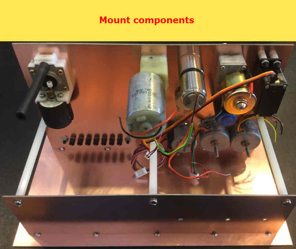

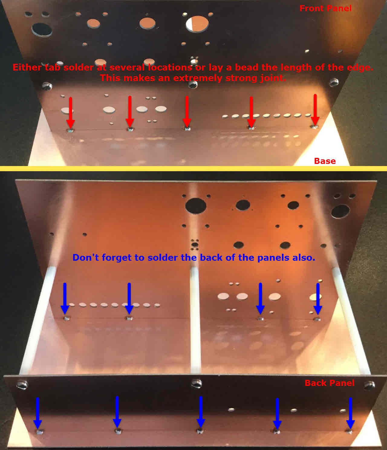

For projects requiring motor mounting or to temporarily mounting other components to prove a design, consider using copper clad PCB material.
This material is: very strong, easily drilled, filed, hole punched and cut.
It solders well and conducts electricity.
Common thicknesses of copper clad board are 1/32 1/16 and 1/8”.
It does oxidize :frowning:
Spray lacquer on the front and look really good bit of retro.
Tom.... :slight_smile:
Yes spray lacquer does work nicely.
When you need to solder a small PCB on one of the panels it gets a real mess with the lacquer .
This is the second time I built this unit as the old one looked like hell after 2 years of soldering.
