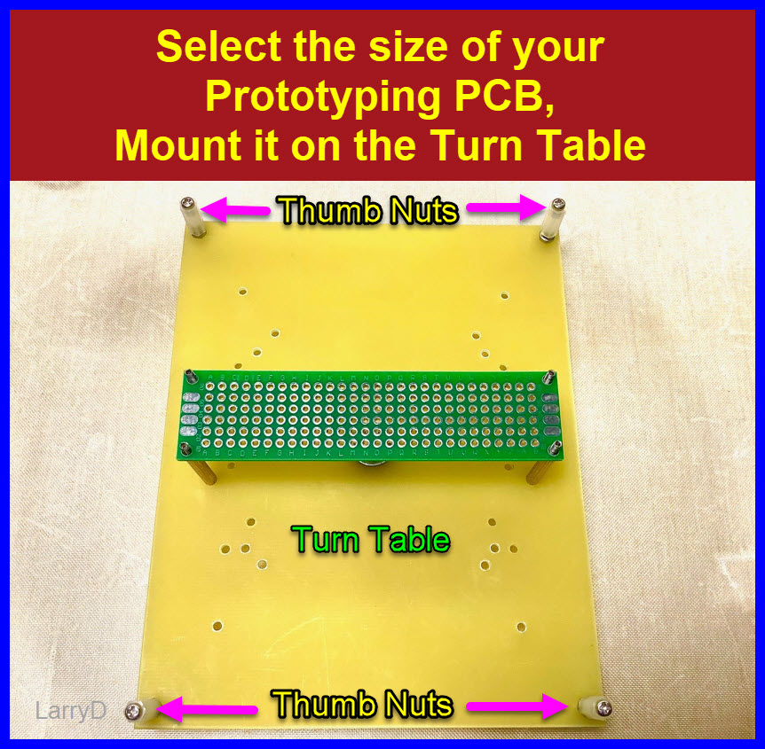

  • The following images show a technique I use to make a one time, Point-to-Point circuit on a prototyping PCB.
    This is a valid way of wiring up a project circuit board; when you need to make several such circuits, it might be time to get PCBs made.

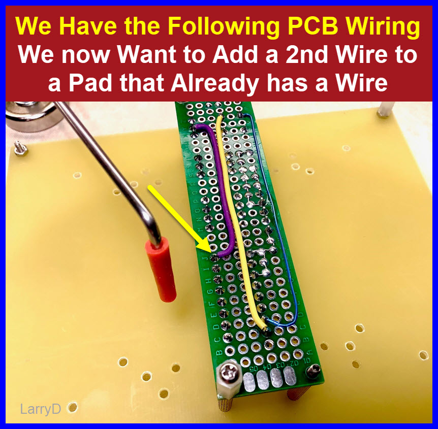

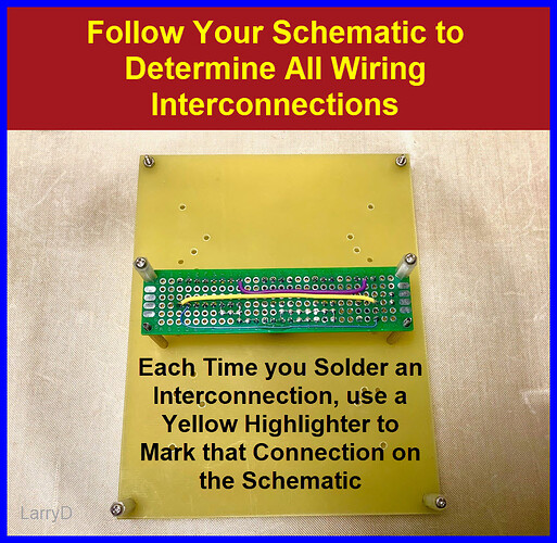

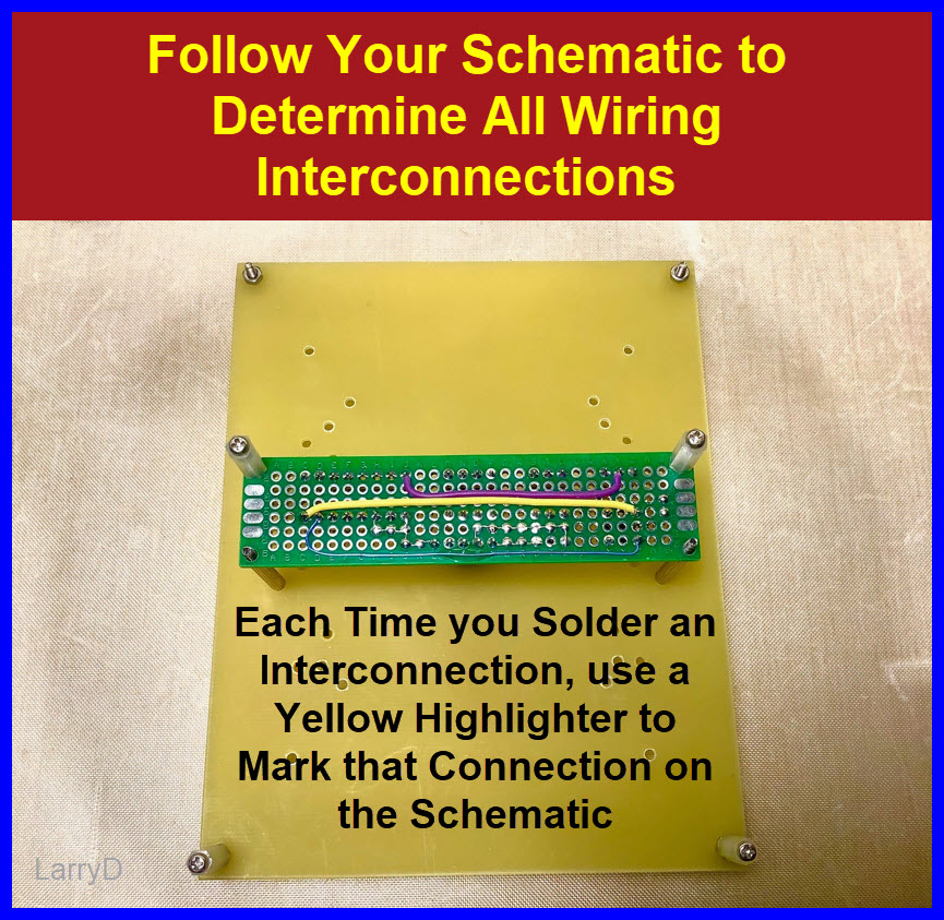

  • The first thing we need is a schematic showing ALL the electrical connections in our project.
  • Flux will help during soldering.
  • After we solder a wire connection, use a Highlighter to mark that connection on the schematic.

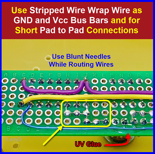

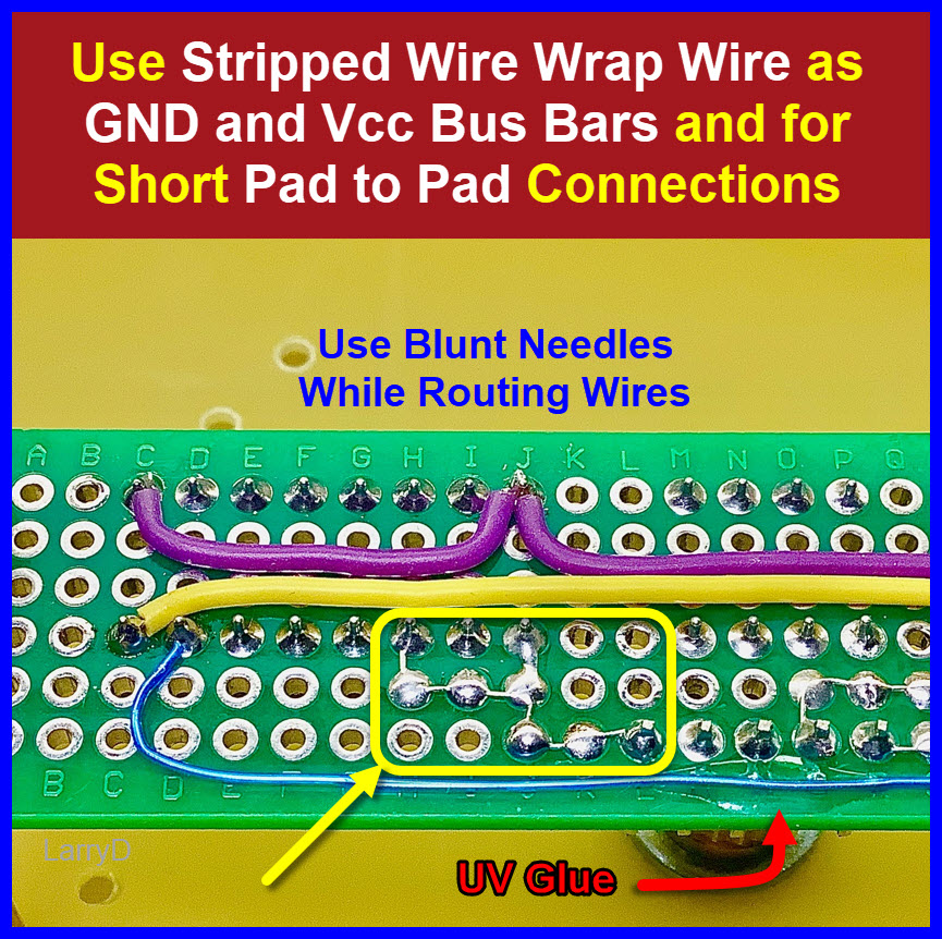

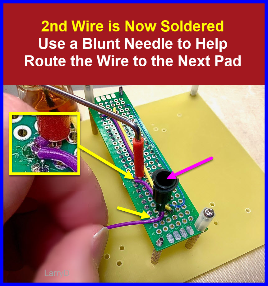

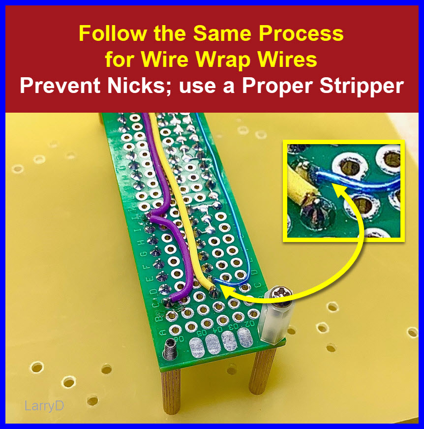

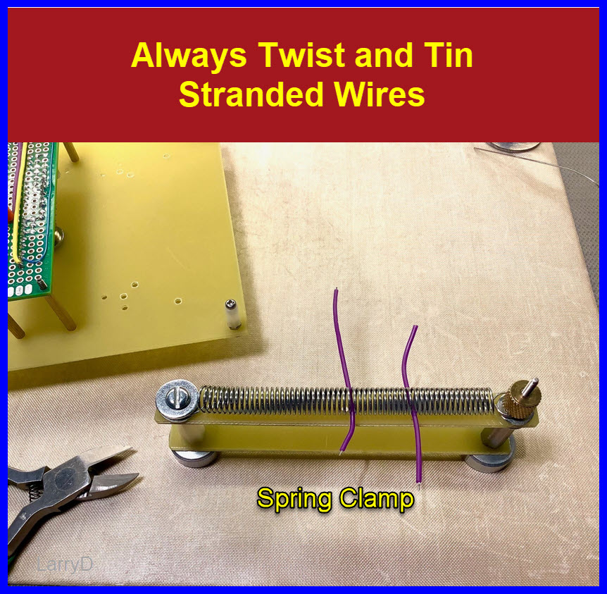

  • Highly recommend you use heat resistant Kynar insulated 30AWG wire wrap wire, and/or 16 strand, 28AWG Silicone insulated wire.
  • Use a proper non-nicking stripper when removing insulation from wire wrap wire.
  • Strip, twist and tin stranded wire.

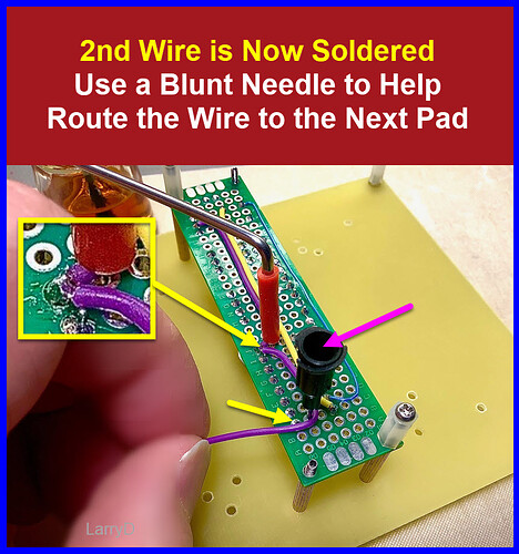

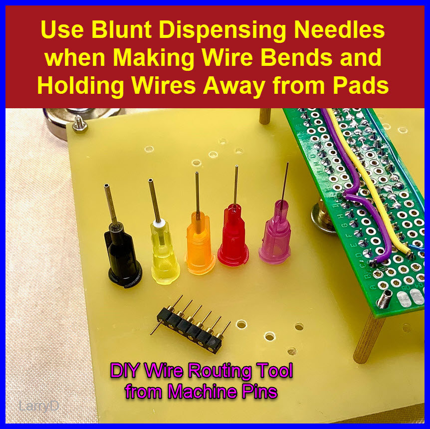

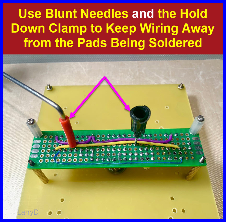

  • Use Blunt Dispensing Needles when routing wires.

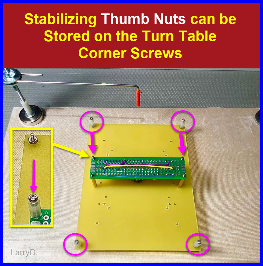

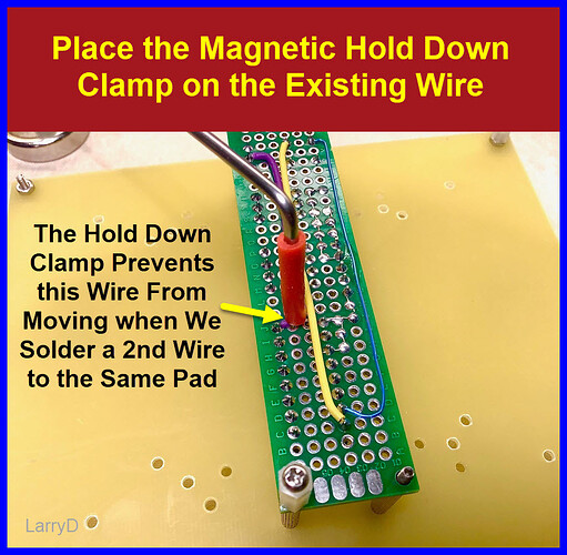

  • The Magnetic Hold Down Clamp is a must have tool to stop wire movement while soldering. The bend on this tool seems to work best when set to ~93°.
  • If there is excess solder on a pad, it will be more difficult to make your wire connections. Remove the excess with Solder Wick.
  • Aim for no more than 2 stranded wires per pad, 3 for wire wrap wire.
    The Hold Down tool is indispensable when attaching multiple wires to a single pad.

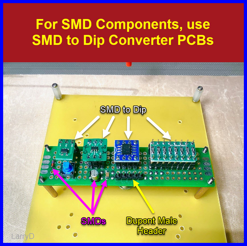

  • Inexpensive SMD to DIP conversion PCBs are a real help when today’s SMD components are used.

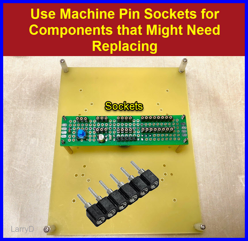

  • Machine pin sockets should be used if there is a possibility of device failure.
  • Keep Components on one side, wire connections on the other.

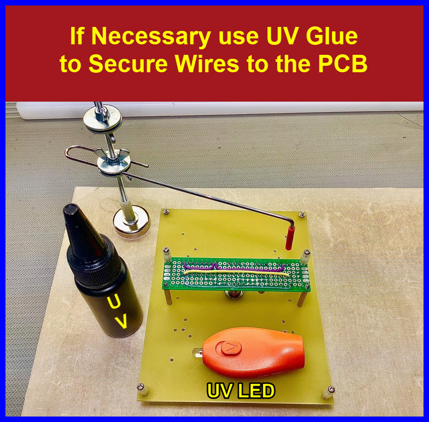

  • If the need arises, use UV glue to secure wires to the PCB.
  • Off board wire connections should be made using Dupont or JST connectors.

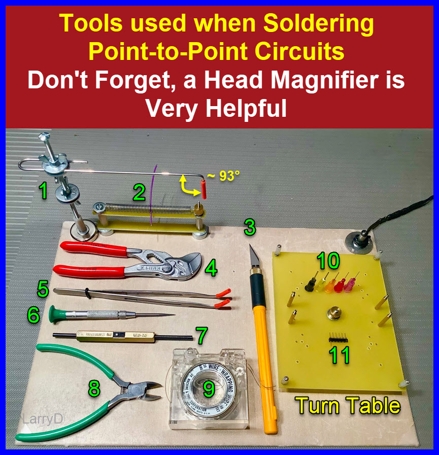

  • Recommended tools in this discussion
1 Tall Magnetic Hold Down Clamp
2 Spring Clamp for tinning wires
3 Sharp hobby knife to cut excess wire wrap wire after soldering
4 Knipex Pliers for holding wire wrap wire while stripping
5 45° Tweezers
6 Sharp Awl
7 Wire Wrap Wire Stripper, non nicking
8 Flush Cut Nippy cutters
9 Wire Wrap Wire with Cutter and Stripper
10 Blunt Dispensing Needles for routing wires
11 DIY wire routing tool

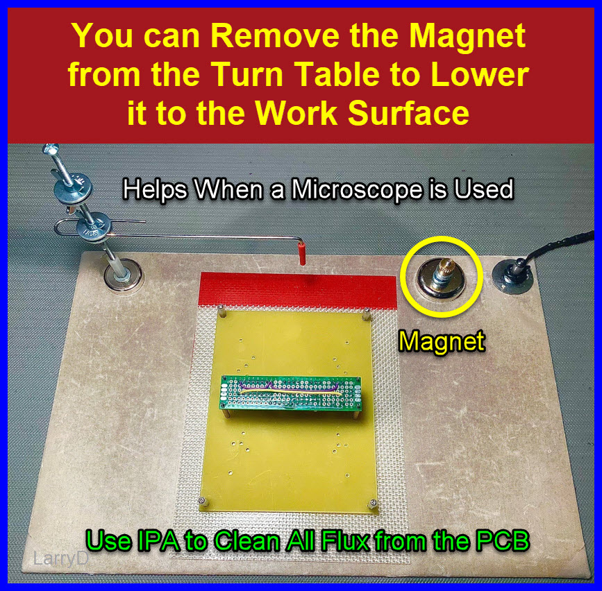

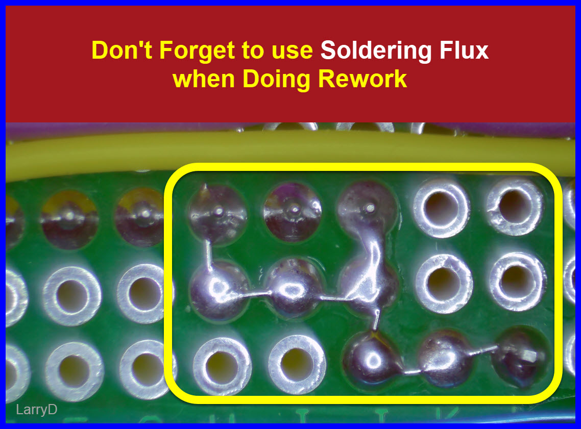

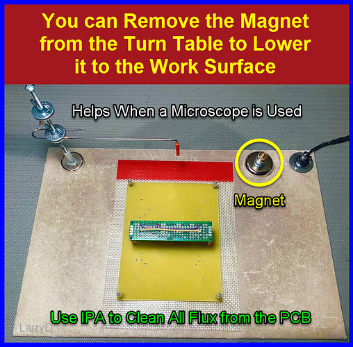

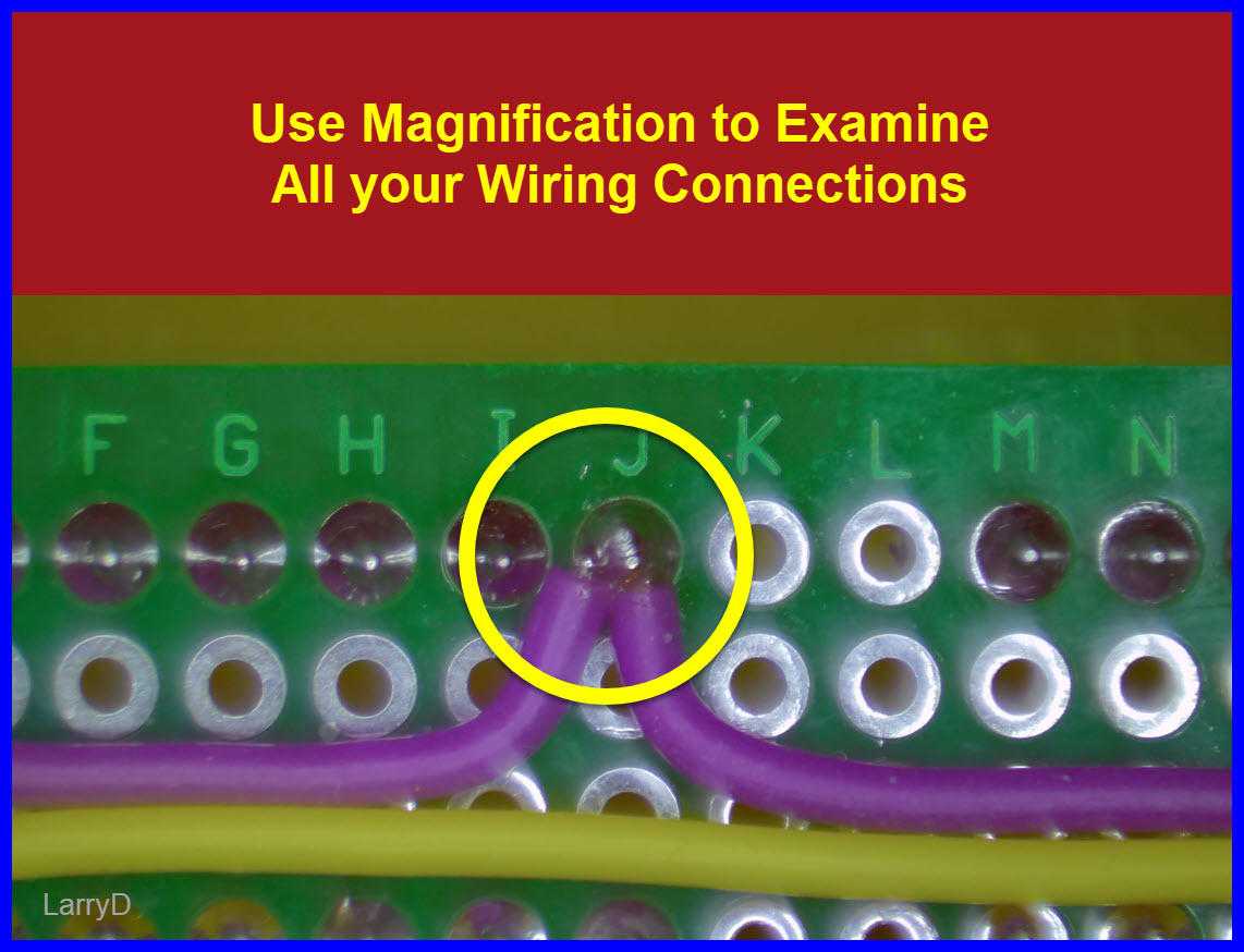

  • Use Magnification to confirm all joints are properly soldered.
    If rework is required, make sure you use soldering flux.
  • Use a soft toothbrush to clean the PCB , use IPA (Isopropyl Alcohol)
