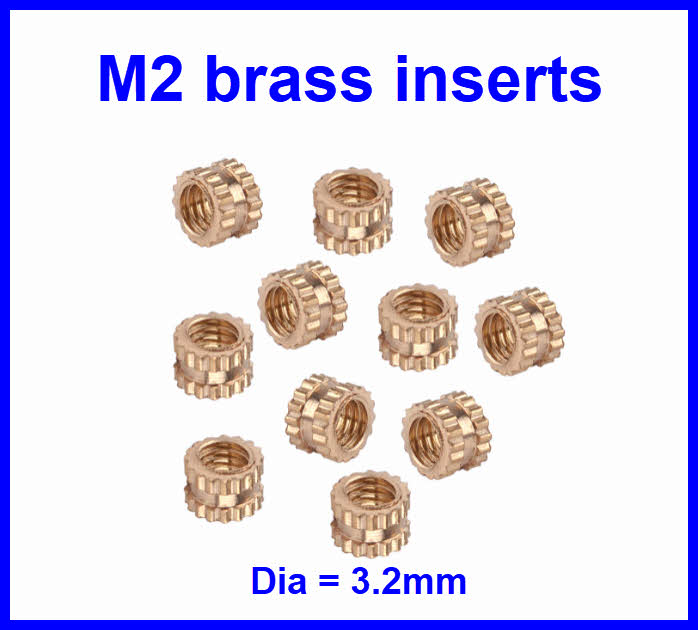

When PCBs are needed to be removed, I use brass inserts that are installed into the plastic nuts.
These inserts are long lasting, inexpensive and easy to use.

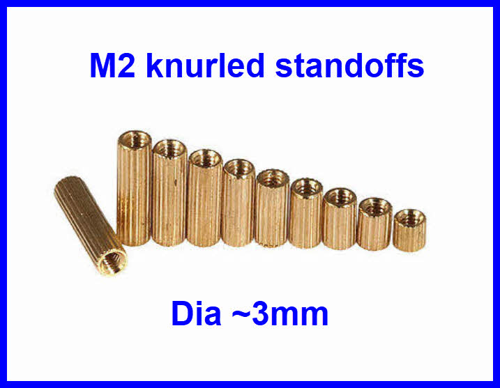

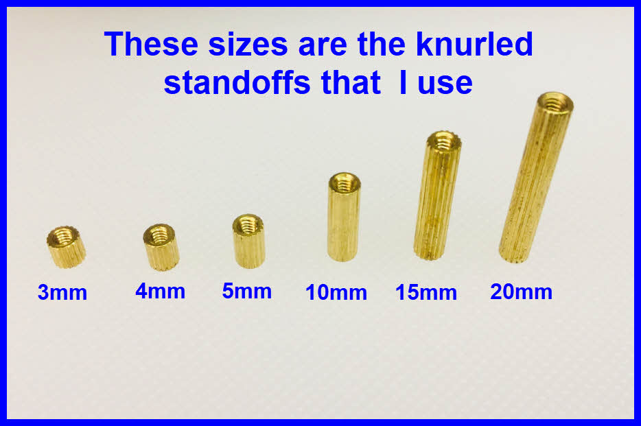

As an alternative to brass inserts, I use M2 knurled brass standoffs.

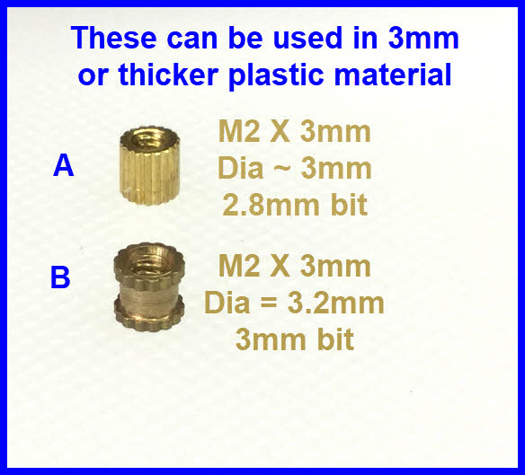

You can see the physical differences between inserts and standoffs below.
The inserts must be used in material that is equal to or thicker than the insert’s length.
Standoffs can be used in material that is thinner than the standoff’s length.

M2 Inserts 100 for $2.00
M2 Standoffs 100 for $4.00

The 15mm and 20mm standoffs are threaded only 5mm from either end.
A = Brass standoff
B = Brass insert
