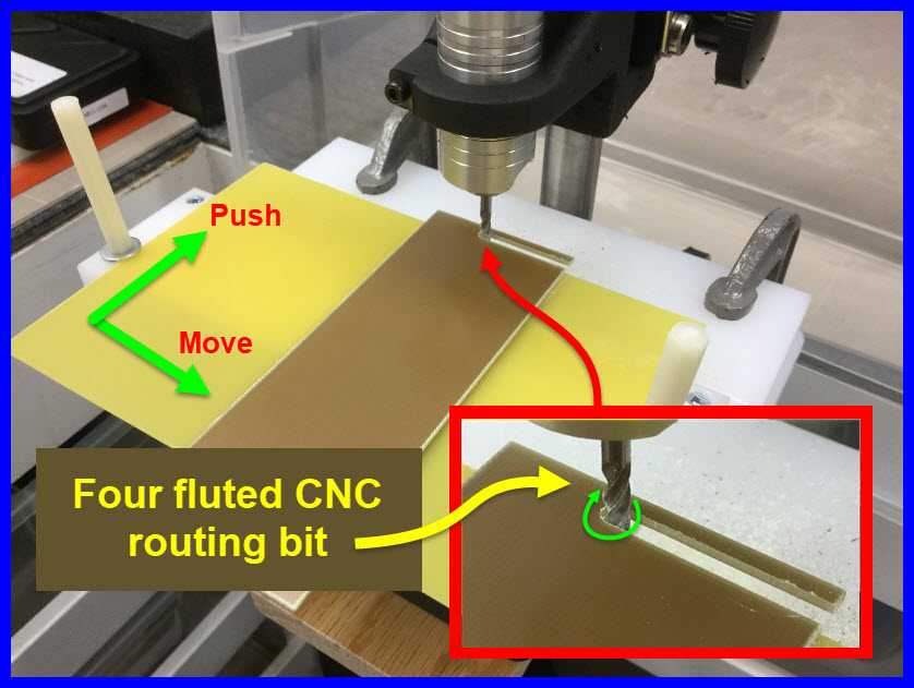

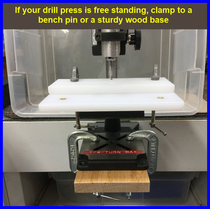

You can effectively use your drill press to cut straight strips of material.

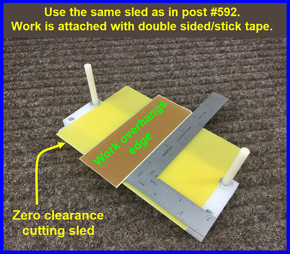

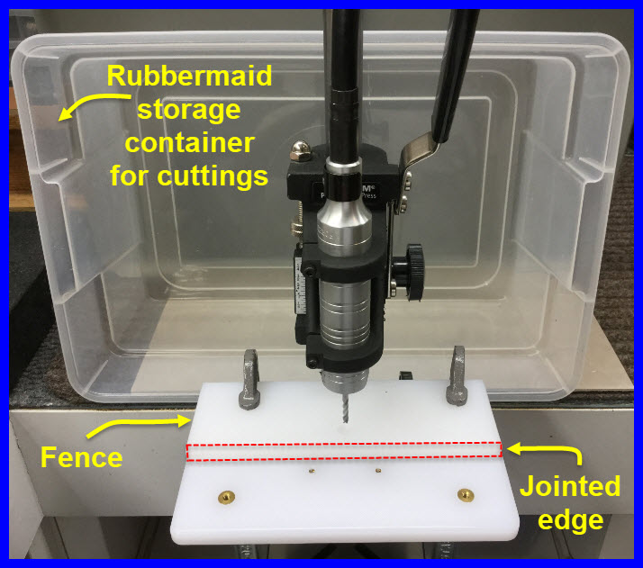

A carbide CNC routing bit, a jointed routing fence and a sled to hold the work is all that’s necessary.
The 'work' is stuck to the sled with double stick tape.
The overhang minus the diameter of the bit will be the final width of your strips.
Let's say you want a 1 inch strip of material.
If the cutting bit is 1/8" you must have an overhang of 1.125"
This method is faster and gives a neater edge than using a saw.
