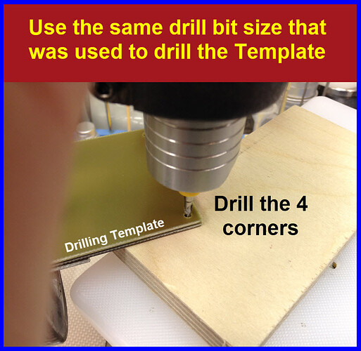

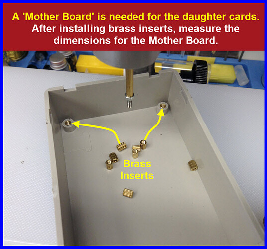

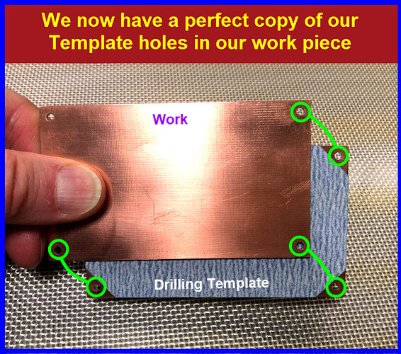

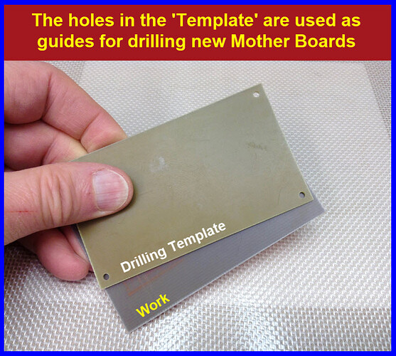

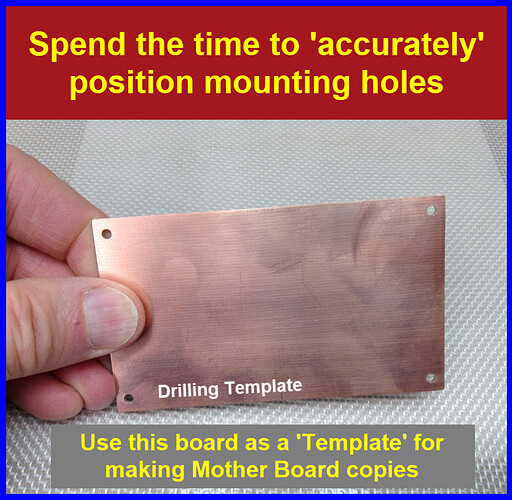

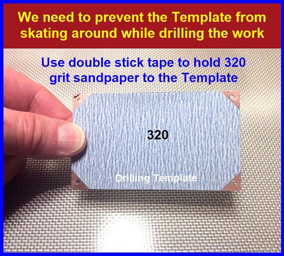

If you are making several copies of a mother board etc., first make a 'Template Drilling Board', use the template to reproduce holes in the copies.
