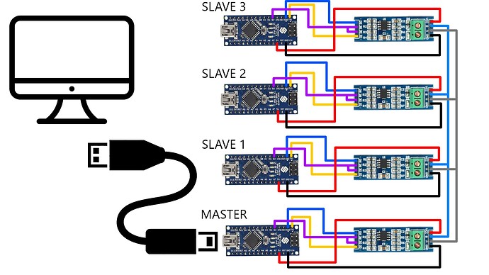

So i have a Windows form application which is connected to my 'MASTER' Arduino with a USB cable. I can write to the port and then execute operations on the Arduino accordingly.
My master Arduino is connected to 3 other 'SLAVE' Arduino's via TTL-RS485 modules.
My question is - How can share the serial communication between all the Arduino's so that if I send a command via the PC that every Arduino receives the command?
Also, the SLAVES need to send back data to the PC with the serial communication.
Any help would really be appreciated
Thank you

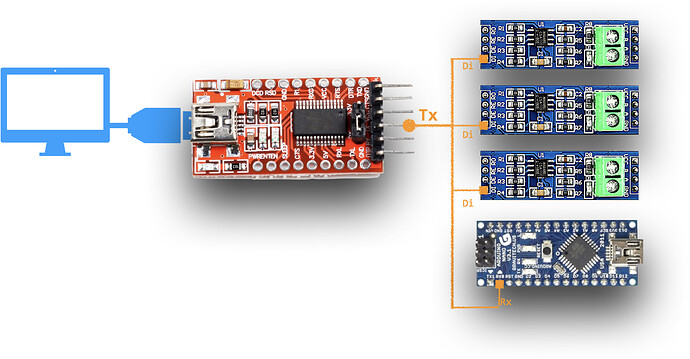

you can have multiple slaves listening on their TTL-RX line connected to the TTL-TX line of your PC. that will work, so all the slaves can get the message
but you can't have all the Tx joined together and sending data back to the Rx of your PC.
Adding a diode on each Tx line and a pull-up can probably do the trick so that you don't destroy your Tx pins but you also need to solve the issue that only one slave will be able to talk at a given time.
of course all the GND needs to be joined

@mr_tropica, when using RS485 with multiple slaves, slaves are identified by an ID. So when you send a message like ID data the slave for who it's intended will pick it up while the others ignore it. You're free to use a common ID (e.g. 0) that all slaves will listen to.
To get data from a slave, you need to use polling and poll each slave in sequence using the unique ID.

I had this in mind (for PC --> Arduinos)

I2C was my first option but unfortunately the distance between the Arduino's is around 1m each for a total of 4m between the last slave and the master
Here is a schematic of how i have my TTL-RS485 and my Arduinos set up now
My code for the master

Code for Slave
#define enablePin 2
String cmd = "";
  pinMode(enablePin, OUTPUT);
  digitalWrite(enablePin, LOW);
  while(Serial.available())
    char c = (char)Serial.read();
    cmd += c;
    if(cmd == "TEST")
      Response("HELLO");
  delay(100);
void Response(String Res)
  delay(100);
  digitalWrite(enablePin, HIGH);
  Serial.println(Res);
  delay(50);
  cmd = "";
