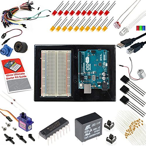

Hello,
I am very new to Arduino, but have done the projects in this package (Starter Kit)
