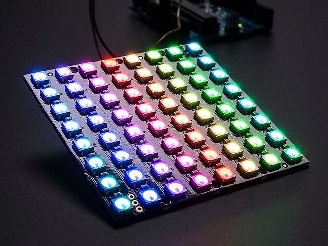

Adafruit and others.
Adafruit has several 8x8 and a 8x32 matrix
It also wouldn't be hard to layout out strips in whatever length x whatever depth matrix you wanted for something custom.
Search Results for 'neomatrix' on Adafruit Industries
Actually, Showcasing Some Product was Not My Concept,
I Wanna Learn And Build Something, So I Started . .
And Came here for Help In Code,
