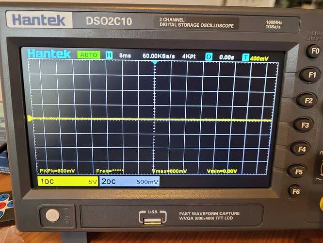

Here you can see the oscilloscope reading, in the picture below, when I try pulling up the signal to 5V (pulling up to 12 V has similar results). With either pull-up voltage, you can see the frequency is more or less what is expected for a fan that sped up to around 3000 rpm with 2 pulses per rotation, however, the amplitude is very low. Around 1 V for the 12 V pull-up and 0.5 V for the 5 V pull-up. In addition, the signal is noisy and neither low voltage is at 0 V. I was hoping to use this signal in my Arduino project, having a signal that varied from 0 to 5V, but using this signal as is makes it hard to properly measure the rpm.
5V pull-up reading

By trace, I assume you mean a picture of the oscilloscope taking the measurement. All pictures were taken with the fan connected and at full speed.
At GND:
At 5V:
At 12V:
