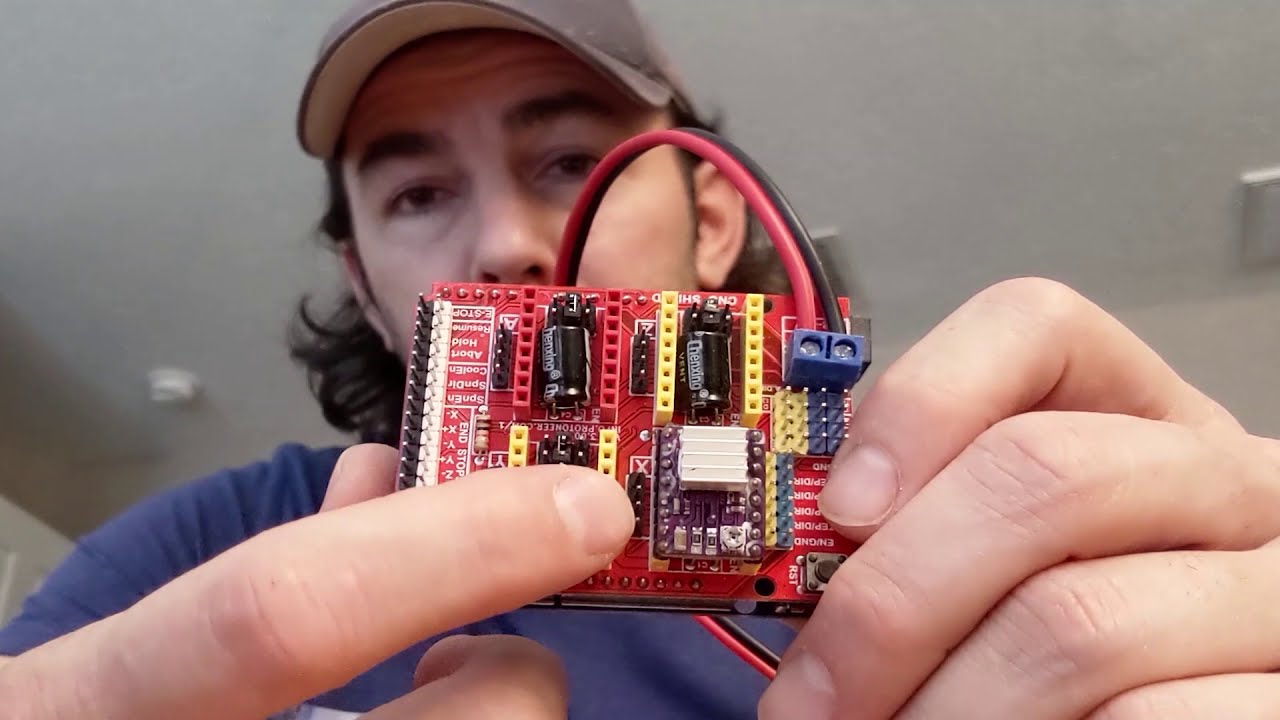

For other folks who might come to this thread, I found this link to answer most of my questions directly, including code and schematics: https://www.youtube.com/watch?v=7spK_BkMJys
