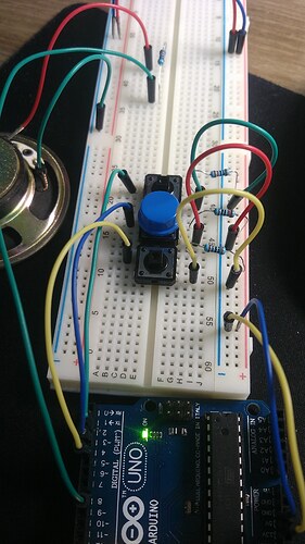

simple keyboard using the tone() function
I'm following one of the tutorials on the Arduino website (https://www.arduino.cc/en/Tutorial/toneKeyboard)
So, I'm trying to make a program where when I press one of the 3 buttons, it outputs a different sound through the tone function out to the speaker.
and because I don't have any force sensing resistors I used 3 push buttons instead. I changed the code up a little but it won't seem to work.
And i connected a 220 resistor to the speaker.
Please help me! I can't find the problem!

With a pushbutton there's no point having a threshold. It's a digital pin which will read HIGH or LOW. Try:
if (buttonReading == LOW)
Do you have pullup resistors on the pins? If not use INPUT_PULLUP, instead of INPUT, on each pin to turn on the internal pullup.
That should get you started.
Pete
You need to make some changes.
You need to remove this line:
const int threshold = 10;
If your push buttons do not have pullup resistors, then you need to change these three lines:
from
 pinMode(2,INPUT);
 pinMode(3,INPUT);
 pinMode(4,INPUT);
to
 pinMode(2,INPUT_PULLUP);
 pinMode(3,INPUT_PULLUP);
 pinMode(4,INPUT_PULLUP);
and make sure that one end of each push button is wired to ground, and the other end is wired to one of the pins (2, 3, 4).
You need to change this line:
from
    if (buttonReading < threshold) {
to
from
    if (buttonReading == LOW) {
20 milliseconds of a tone is not very much. You might want to try 200 or 2000 for testing purposes.
this is the circuit i made
please tell me what the problem is

That does not mean much; please describe what it does not do and what you think it should do.
Your button reading will either be 0 or 1 (LOW or HIGH); both are lower than the threshold. Change
to
or
if (buttonReading == HIGH) {
If that does not work, you will need to check the behaviour of the button using a multimeter; you might have wired it wrong.

This is how I wire buttons
  GND
   |  +-- pin
+--o--o--+
+--o--o--+
And I will make use of the internal pull-up.
  pinMode(2, INPUT_PULLUP);
  pinMode(3, INPUT_PULLUP);
  pinMode(4, INPUT_PULLUP);
When the button is pressed, it will read low
