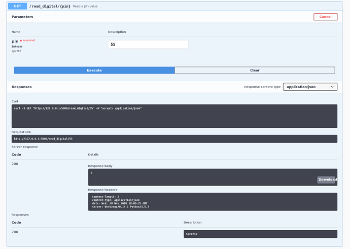

ron_sutherland:
The pain is crafting the URL for the RPC, ...
I quickly whipped up something using Swagger. Please note that REST conventions are not followed, this is purely a proof of concept.
In the browser an overview of all exported methods can be seen:
From this page it is possible to select a method, supply it with input (if applicable) and execute the method. The result shows up on the page:
Other clients like curl seem to work fine as well.
